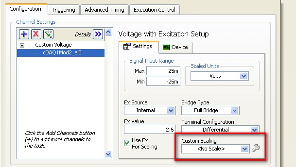

What version of NI-DAQmx do you have installed?  I have NI-DAQmx 8.9.5 on my machine, and this is what I have under the Custom Voltage with Excitation setup tab.
I went over to a test machine which has NI-DAQmx 9.0 installed.  With the new driver, we now have the ability to calibrate a Custom Voltage with Excitation task.

I'm not sure how to tell what version of NI DAQmx I have installed, however in my Custom Voltage w/ Excitation setup I do have a Calibrate... option as shown in your second screen shot.
