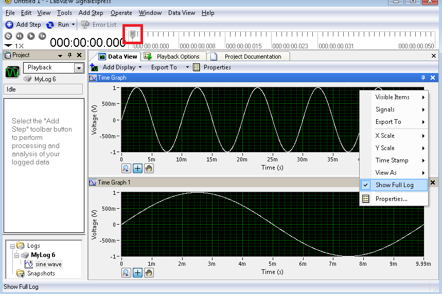

So there are a couple of ways you can do this depending on what you're trying to achieve. Here is a screenshot of a couple of a few examples:
1) Both graphs are showing the same log. However, on the top graph, I told SignalExpress to show the entire log as shown in the right-click menu of the top display. The bottom graph is showing the data at time 0:00:00.00000 as shown by the timeline Time next to the red box. In this case, the bottom graph is showing the amount of data specified by the "block size" control in the screenshot near the top of this thread. The bottom graph is the equivalent of your own "1st block".
2) If we ignore the top graph for a minute because we want to use the "block size" control to govern the amount of data we see, the red box in the screenshot is showing you the Timeline Slider. By dragging this slider to the right, you will see the data that comes after. This is what it sounds you were looking for. As you move the slider, you'll see the Time indicator change to tell you the new start time of the data you'll be looking at. Note that this Time is relative to the start of the log; this is why it starts at 0:00:0.00000.
3) Also note that pressing the Run button on the toolbar will automatically run through data block by block, as configured in the playback options.
I don't know if you've had a chance to run through the SignalExpress Getting Started, but it does offer some great help regarding Playback mode, and so does the general SignalExpress Help.
I hope this answered your question...
Phil
