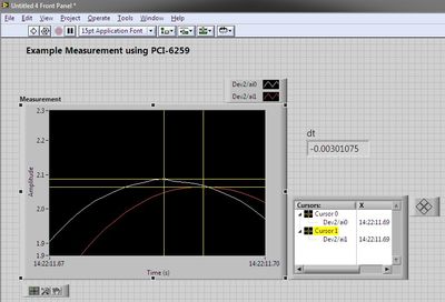

I took your Signal Express Project as well as created a LabVIEW VI to double check, and you can see exactly the same offset between the two
sampled signals. If you want to measure true phase differences, you got to use an simultaneous sampling device like the S-Series or DSA devices (there are a few more others).
