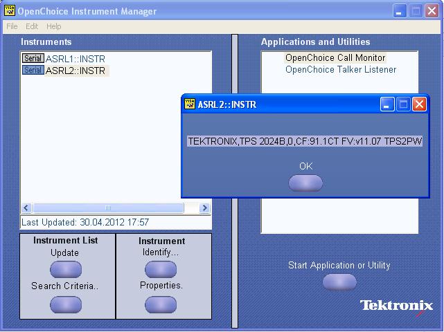

I am able to connect to my device and get its identification via Open Choice Instrument Manager. It is connected with the USB/RS232 cable supplied. The port is named as COM2 in the Device Manager. I can also get waveforms via OpenChoice.

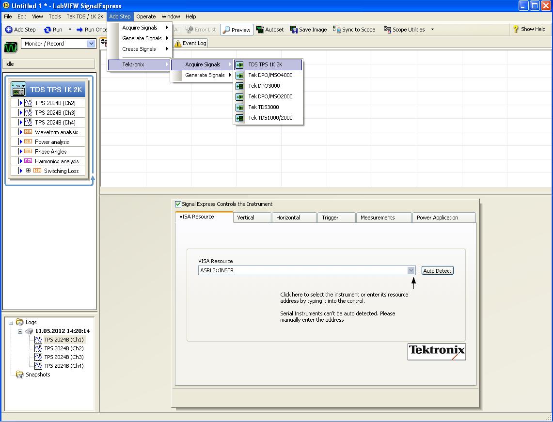

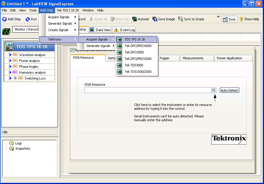

My main problem is: Whatever I select as the VISA Resource, "ASRL2::INSTR" , "ASRL2" , "COM2" I'm notified that it is an "Invalid VISA Resource". Autodetect doesn't work (As it is stated in serial connections), and the drop-down menu is greyed out. This is where I fail to continue with the instructions in the document.

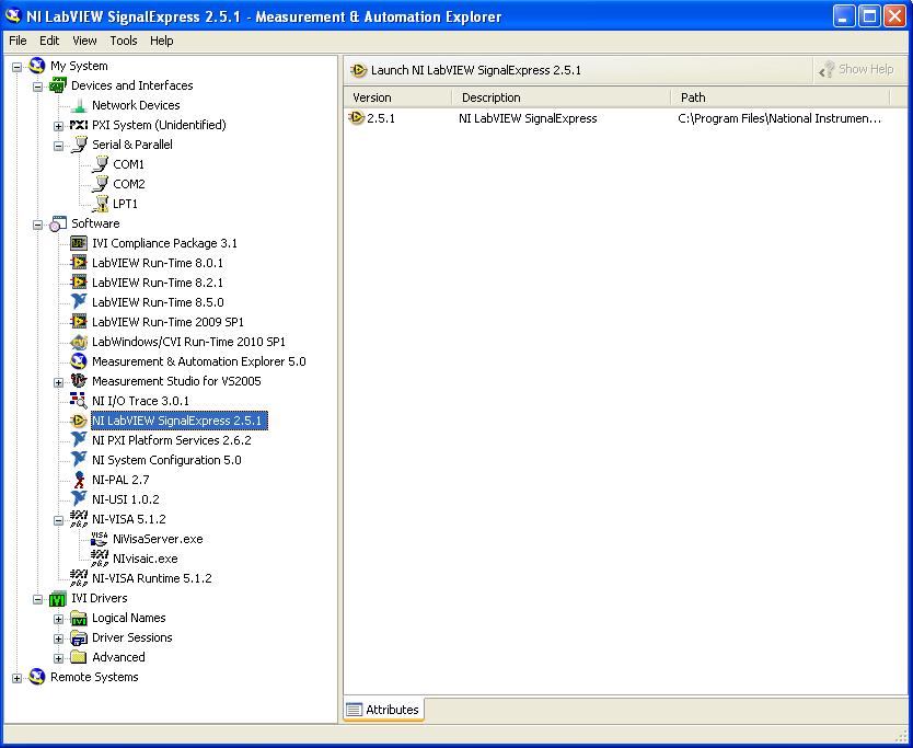

Thank you for the detailed post and all the corrections. Thanks to that I was able to see what software you had installed and I noticed that your Measurement and Automation Explorer was missing the Devices and Interfaces dropdown menu which would have all your serial and parallel devices listed. It seems like the installation did not work properly.
I might have you upgrade to the most recent version of NI-VISA to make sure that it gets installed correctly.
Let me know if that helps and please let me know if you see Devices and Interfaces in MAX after the installation.

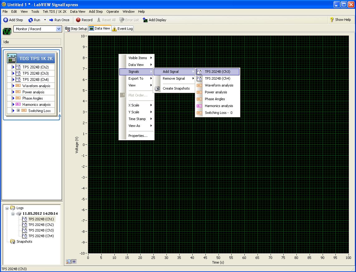

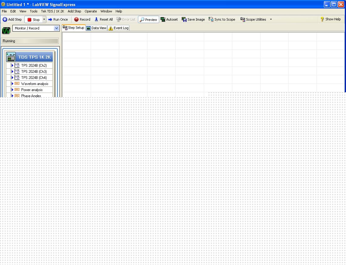

Jacob, thanks for your response.
I installed the software, right now I was able to advance, though, I faced another problem.
I will try to explain my recent state.

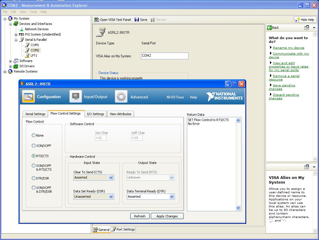

My measurement and automation software shows my COM2 poart, and I am able to set my Baud Rate and such.
I am able to connect to my ossiloscope via  Signal Express,

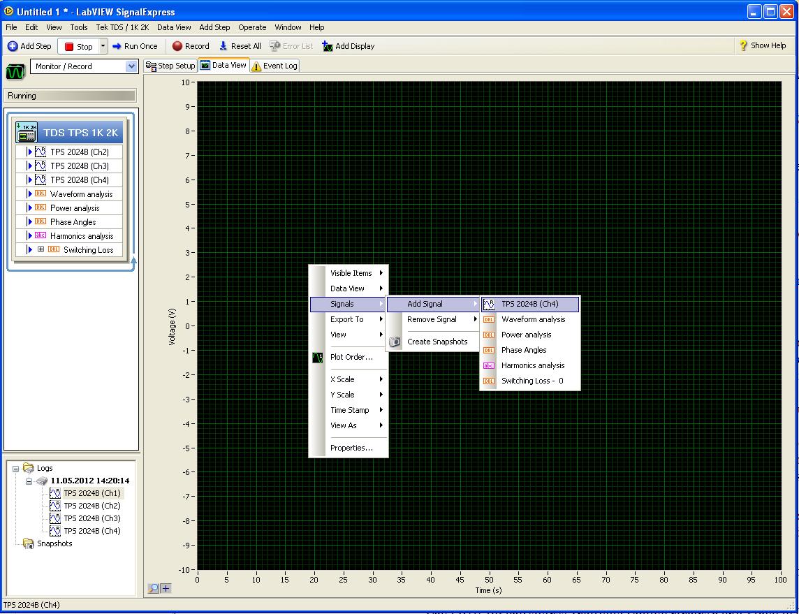

But, When I try to add a signal to the Data View, and Run the whole system, the scope is set into Scanning Mode, but the signal is not shown in the Data View. Also, the Step Setup plot is empty.
I must say that my configuration is imported correctly, but no real time signal data is communicated, as I presume.

Have you been able to communicate with the device from the VISA test panel in MAX? For example sending the *IDN?\n in the Input/Output tab?
Could you also send the screenshot of the software you have installed from MAX?

Greetings,
"Let me make sure of the order you are doing things; first you add a step for your Tektronix device, then you add a channel, and then you hit run continuously and nothing populates in the Step Setup or Data View?"
Yes, when I run SignalExpress, I add a step for my device, TDS TPS 1K 2K, I set the VISA Resource Name as ASRL2::INSTR, and if it is able to communicate with the scope, the menu on the left lists 4 channels of the scope. Then I add a signal (I don't know the distinction between a channel and signal in the scope, but I do as I showed in the previous post. There is a channel view in which it states "No devices available", though) in the data view, and I hit run continously. Nothing populates in the Step Setup and Data View tabs.
Yes, when I send the scope *IDN\n it returns a string starting with TEKTRONIX, TPS 2024B, 0
Sure. Following is the screenshot.
Message 5 of 8
(10,867 Views)

In Open Choice Instrument Manager I can only see the VISA References, and identify instruments. I don't see anything resembling channels.
