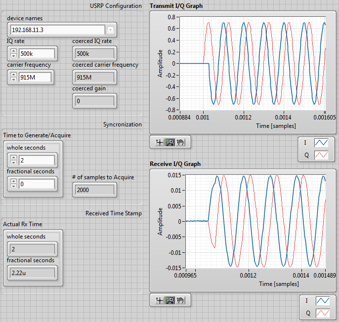

This example combines two shipping examples and eliminates some redundant function calls.
See the following shipping examples for reference
niUSRP EX Rx Finite Sync.vi
niUSRP EX Tx Finite Sync.vi

I am trying this example using a USRP 2920 but most of the times the received signal is different than the original like the image below..
This gets worst when i try transmit a different signal with more changes
I am new with the USRP so maybe I do something wrong..
Any tips or advises how to get this correct?
You are doing everything right! The RX signal is a rotated (phase offset) version of the TX signal. The LO's are not shared between TX and RX. The two phases will change every time the LO's retune, but when plotted on an IQ plot they will be rotated versions of one another.

Hello, the image shows that there is a delay between Tx and Rx, is there a way to match one to one?
