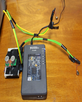

figure 1 : Our device fully assembled
(5) NI myRIO-1900
This module is equipped with 10 analog inputs, 6 analog outputs, 40 digital I/O lines, wireless, LEDs, push buootn, accerlerometer onboard. and Xilinx FPGA and dual-core ARM Cortex-A9 processor, Programmable with LabVIEW or C; adaptable for different programming levels. It receives the trigger pulses from the ultrasonic sensor SRF-05 and uses them to measure the intervening distance and transmit echo pulses to LabVIEW.
