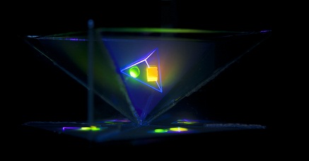

In this part, we use LabVIEW to read the virtual 3D model document and set parameters , then show the four images of different directions of the model in one image as the figure 2.2shown , such special image is projected by a projector to an Inverted pyramid optical structure of Figure 2.1 as the Schematic of Figure 2.3.
Figure 2.1 Figure 2.2 Figure 2.3
Figure 2 Imaging principle
Figure 3 and Figure 4 are Specific examples of three-dimensional display.
Figure 3 three-dimensional display of virtual model
Figure 4 three-dimensional display of virtual model
