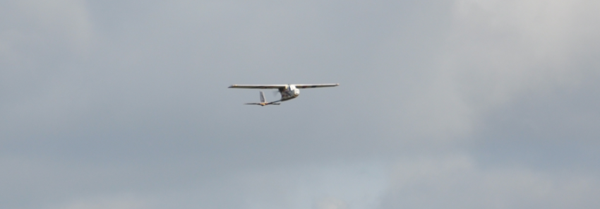

The project was successful in producing a UAV Test Bench and an autonomous UAV. The UAV Test Bench was vital to the success of the project and enabled the autopilot to be developed in a simulation environment. The PID tuning techniques allowed the PID parameters to be determined and used on the UAV Controller. Overall, the response of the autopilot seen in the test flights was very similar to that of the Test Bench. A number of test flights were conducted at a local model flying club. The UAV was able to maintain level flight as indented in windy conditions as shown in Figure 10.

Figure 10. UAV Flying Autonomously
