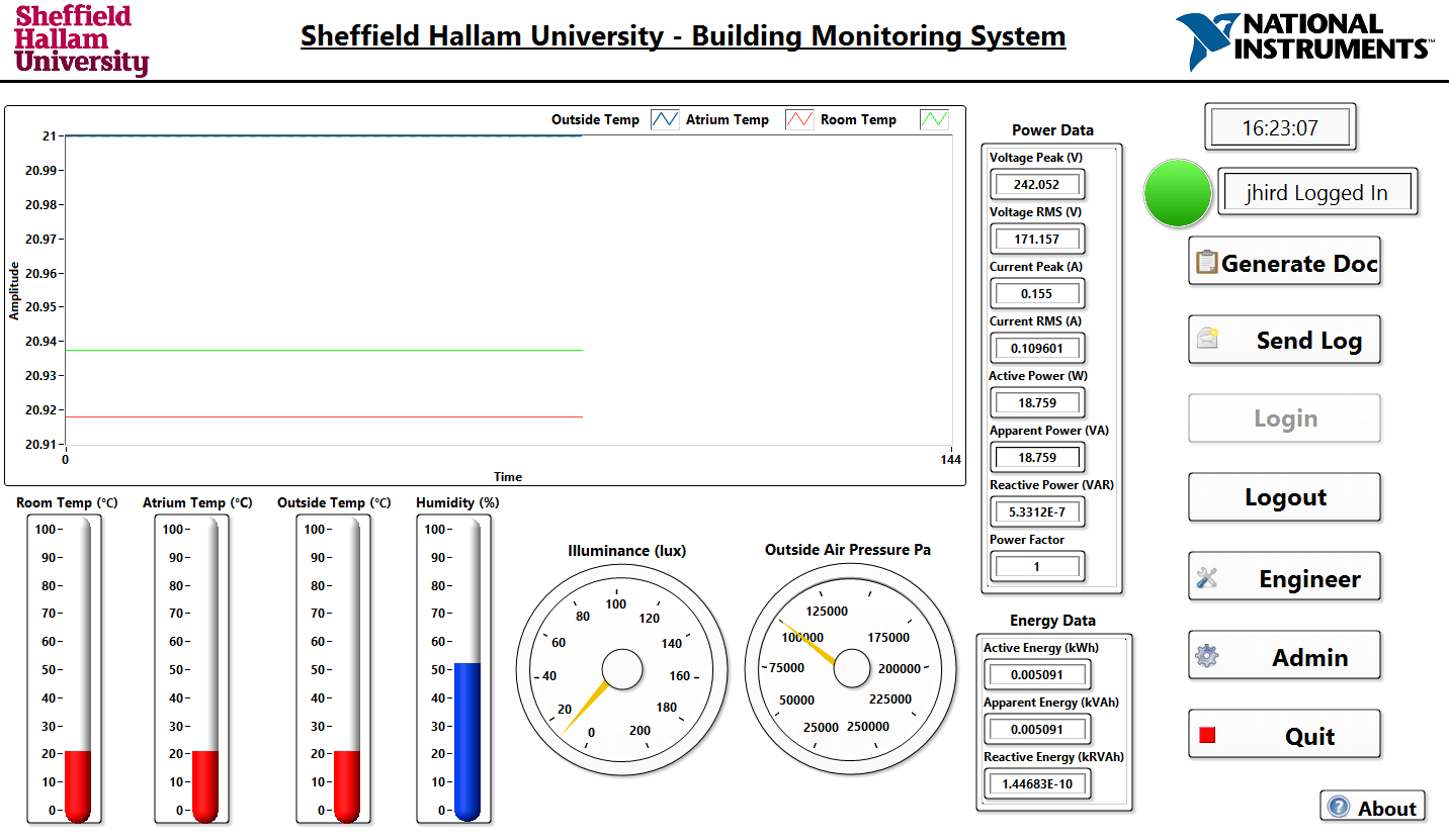

There are 3 main screens on the host application, the main one being the general UI (Figure 4) that shows all acquired data in real time, the other two screen are accessible via an encrypted login system in which different credentials provide access to the admin screen and engineering screen. The host application also performs a redundancy logging operation, creating copies of TDMS logs to a defined folder on the PC as well as providing a separate optional SMTP execution that can be activated manually or automatically at pre-defined times. In addition to this functionality, report generation is also available, the application uses the report generation toolkit to collate a range of data points and associate them with bookmarks contained in a pre-made Word template (Figure 5).
Figure 4 - Host Application UI

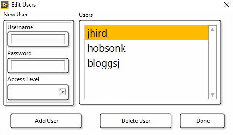

The Admin and Engineer screens provide 2 core functions:
1) Admin of login credentials
2) Viewing of system data such as memory, errors and heartbeats of the system
Both screens solve the issue of lack of system visibility when the myRIO is operating headlessly and can be seen in figure 6.
Figure 6 - Engineer & Admin Screens
