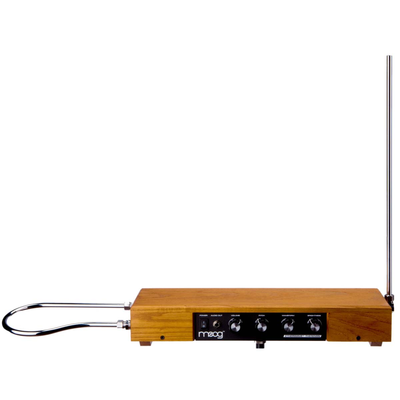

Figure 1 the Theremin
The Theremin is an electronic musical instrument, which was invented in 1919 by the Russian scientist Léon Theremin. The Theremin can be played by the performer without physical contact. There are two antennas on it, the horizontal circular antenna is used to control the volume and the vertical straight antenna is used to control the audio frequency.

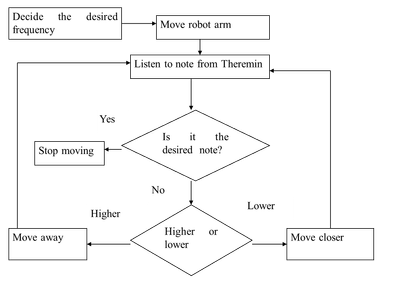

Figure 2 operation principles of Theremin (http://asmir.info/theremin_classic.htm)

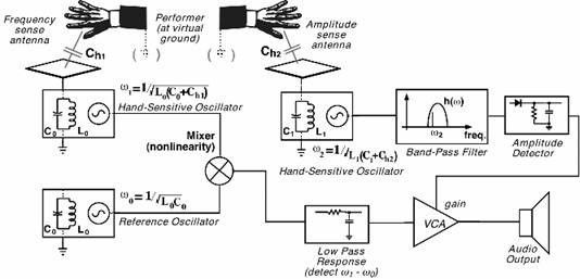

The audio frequency is controlled by the performer’s hand or anything else close to the vertical antenna. From figure 2, there are two high frequency oscillators inside the Theremin (around 350 kHz). One of them is a fixed-frequency reference oscillator, the frequency of the other is varied by the capacitance of the hand close to the antenna. The difference between the two frequencies will decide the audio frequency, and the difference is equal to the frequency of the note being played. The proximity of the performer’s hands to the antennas affects the capacitance of the antenna, which determines the frequency of the associated oscillator.

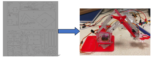

Figure 3 build a robot arm

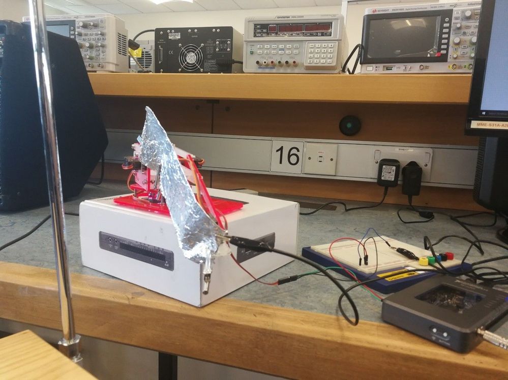

In this project, a robot arm that can receive the control signal and provide precise control is needed. So I chose a robot arm the core component of which is the MG 90S servo motor. A sheet of grounded aluminium foil is attached to the robot arm to form a “hand” which forms the capacitor with the antenna. Otherwise, the antenna of Theremin cannot sense the robot arm. For the robot arm, we can simply use the myRIO-1900 to generate the PWM signal to control it. And the PWM signal can be adjusted by building a feedback loop.

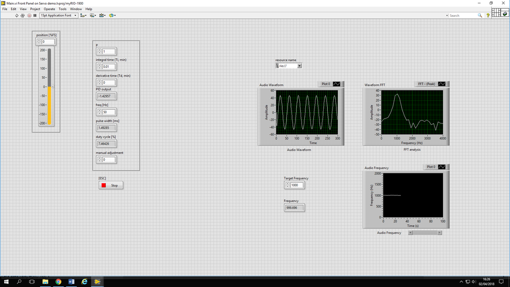

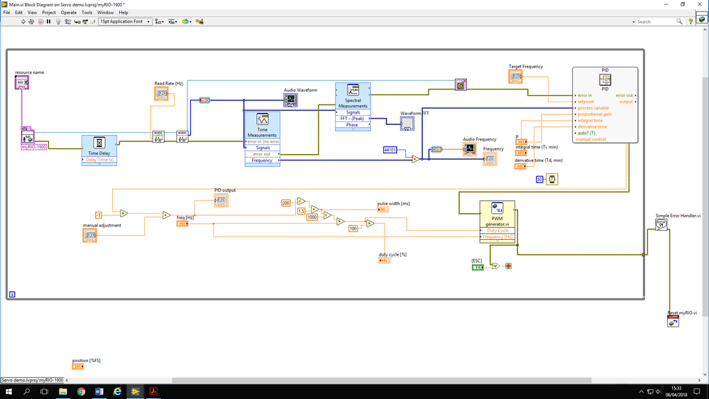

In this part, the audio I/O port on the myRIO-190 can be used to acquire the audio signal from the Theremin and analyse it. Also, the FPGA module in LabVIEW is used in this part. The change of audio frequency which can be distinguished by humans is 3 Hz. So, I used a calibration audio signal of 1 kHz to make sure the error of the measurement is acceptable.
Figure 5 control the servo motor in robot arm (http://www.societyofrobots.com/actuators_servos.shtml)

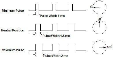

Changing the pulse width of the PWM signal which applied to the servo motor will make the motor move to a specified angle. If I set the error between target frequency and actual frequency as the feedback value, the control signal of the robot arm can be dynamically adjusted. When the actual frequency is far from the target frequency, the robot arm will move quickly, when the actual frequency gets closed to the target frequency, the robot arm will move relatively slowly until the target frequency is achieved. In this part, the PID controller in Real-time module is used. A time delay is set for the robot arm, to balance the operational speed of the robot arm and other hardware.
Figure 6 LabVIEW code
Figure 7 robot arm and circuit
