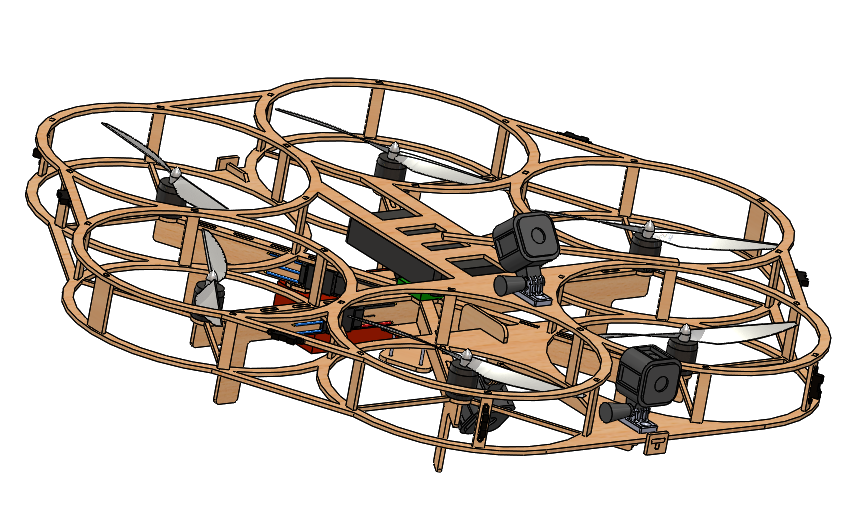

CAD model of the drone.

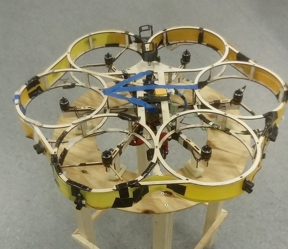

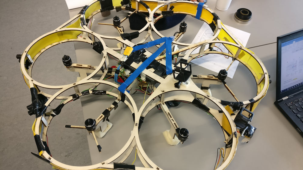

The autonomous drone. Direction of flight marked with blue tape.

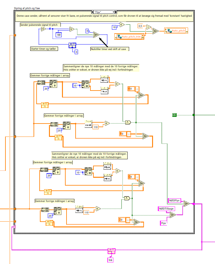

The drone is build as a state machine, controlling the movement. When the drone is airborne it mainly changes between an idle state and obstacle avoidance states.

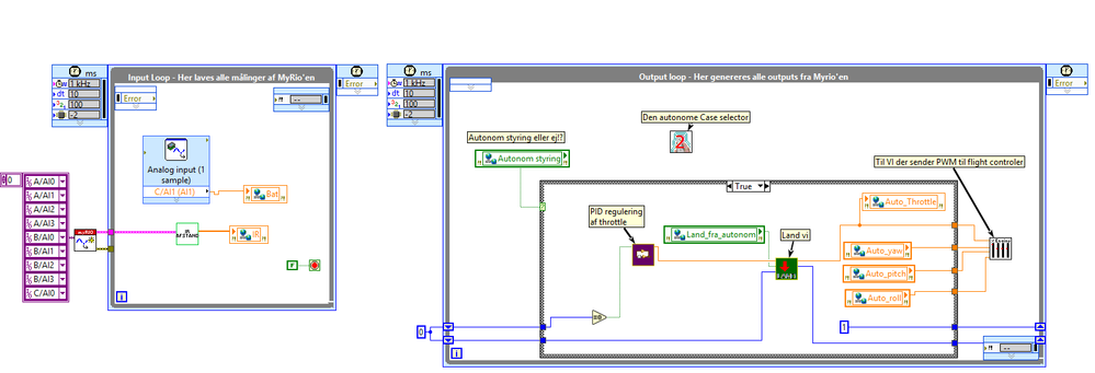

Data acquisition is done in a parallel loop. This makes it possible to run the data acquisition loop very fast, and make signal processing on the data.

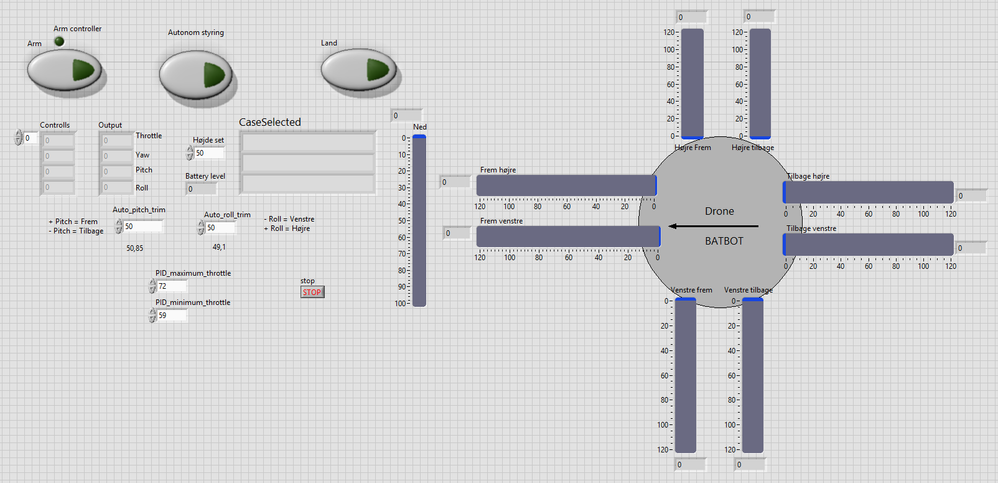

A base station is set up, consisting of a laptop running LabVIEW. From the base station the scanning operation is initiated and the drone can also be landed from here. Furthermore, the bases station allows for manual control of the drone for testing. The base station communicates with the MyRIO on the drone using WIFI.
Front pannel of ground satation
Main state machine
MyRio main program
