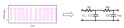

Since the myDAQ only has 2 analog outputs and needed a third one, we are using the digital output 3 (which is the internal counter of the myDAQ) to generate a PWM signal. A low pass filter has to be built with two capacitors and 10k resistors in order to filter the PWM signal and get smooth DC value. This is a really easy and quick way to obtain a 3rd analog output from the myDAQ using a digital output.
