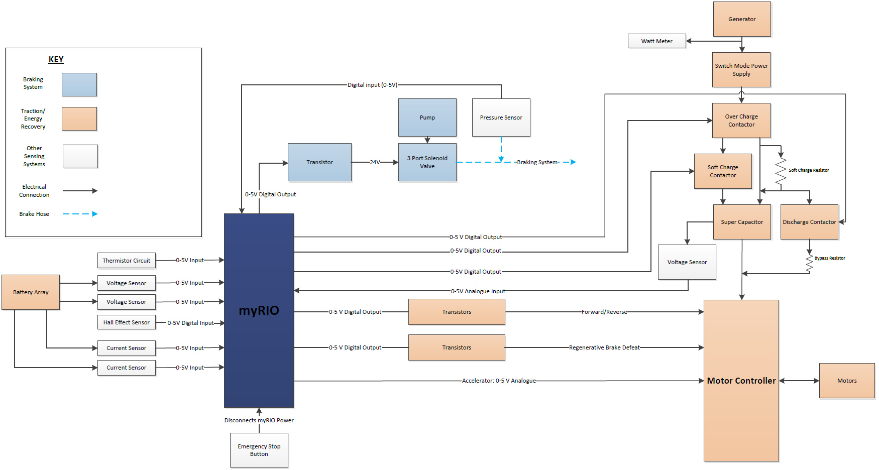

With so many systems to control, the electronics and control team decided to tackle each subsystem individually. This allowed the testing and troubleshooting before combining the systems together.Whilst other subteams were finalising their designs, the inputs and outputs for the various functions were planned out to allow for constant moniroting of the design and control implementation process. The diagram below shows the final systems diagram:
Figure 1: Full systems diagram showing the inputs and outputs from the myRIO

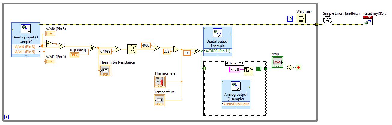

Fire Detection
The technical specification of the competition requires the employment of a fire detection system that uses heat detection. Once activated, the system shall give an indicator to the driver and activate the brakes.
Because of their suitability for the application, a fixed heat detector concept was used. A 1k Ω thermistor was connected in series with a 1k Ω resistor. A VI was created to measure the voltage across the thermistor and calculate its resistance. Using the stein-hart hart equation, the thermistor’s resistance is used to calculate the temperature of the locomotive. A threshold temperature is set so that when the measured temperature exceeds the threshold temperature, a digital signal is sent to the brakes channel to activate them. The same signal is alo used to activate a pop-up box to indicate to the driver that there is fire in the locomotive.
Figure 5: Fire detection VI

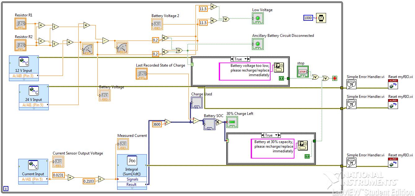

As part of the electronics & control subsystem it was required to design a low voltage DC supply system for components such as the brake system solenoid, myRIO microcontroller and energy recovery circuit contactors. Two 12 V 55 Ah sealed, rechargeable lead acid batteries were selected as the ancillary power system. They are not charged on the locomotive but are easily accessible for replacement and batteries have been proven to last multiple days at a time. The selected ancillary power system is completely separate from the primary source such that in the event of a primary power circuit fault the myRIO is still powered and so functions safely. The voltage of the batteries is monitored so that the battery circuit is disconnected when the batteries voltage falls below a certain value. The monitoring of the current is done using Hall Effect current sensors.
Figure 8: VI for monitoring the batteries voltage and SOC
Figure 9: Front panel for battery voltage and SOC

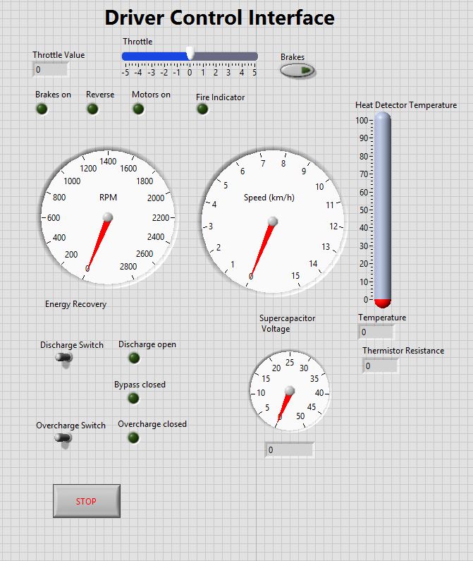

The use of myRIO and LabVIEW has allowed flexibility and ease of programming for the project. At the beginning of the project, none of the team members had any experience with LabVIEW prior to the project. In a matter of weeks, the team was able to design and construct systems that are able of controlling a whole miniature locomotive. The graphical interface was very helpful for troubleshooting and creating quick test virtual instruments and proved to be very useful compared to scripted programming languages. With the importance of remote control in this project, the Wi-Fi hotspot feature and NI Data Dashboard application provide an easy and user friendly operator experience. Below is a screenshot of the preliminiary laptop GUI that was used during the first stages of testing:
Figure 10: Driver GUI

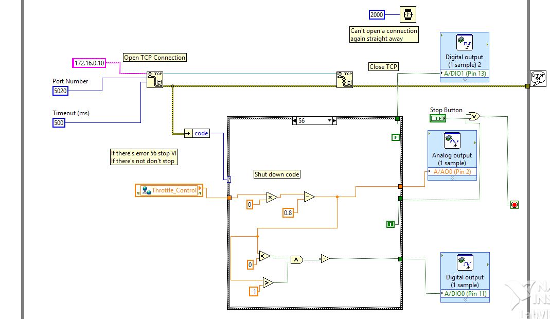

Update to Saftey measures
As part of the competition rules, it was required to deploy an emergency disconnect where in the case of Wi-Fi loss, braking is deployed. To achieve this, the TCP protocols tools were used. The TCP open function continuously searches for the tablet's IP address. In the case of communication loss,an error is sent to the control case structure and a signal is sent to the data dashboard application that immediately reduces the speed of the locomotive and applies the emergnecy brakes. A screenshot of the code is shown below (Many thanks to Charlotte Nicolaou from NI for her help with this problem):
Figure 11: Emergency disconnect VI
