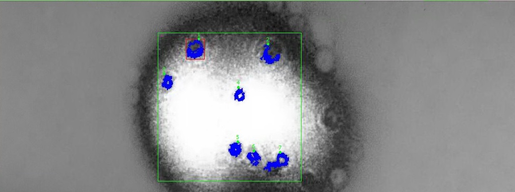

A green laser was illuminating low concentration bacteria sample deposited on a glass slide. The images of the diffracted pattern were captured by a web camera. Samples containing micro beads, rod and spiral shaped bacteria were used in the study. The diffracted images of the sample were then transferred into the computer by NI Vision Acquisition and analyzed by NI’s Vision Assistant to check the presence of bacteria or micro bead and differentiate them based on their morphologies. This process was done by extracting luminance plane (grayscale) from the color image. A particle classifier tool was used to examine the bacteria structures and differentiate them by comparing the structures with the pattern template that has been stored in the database. A program in the LabVIEW was created to store the particle classifier information and create a report describing content of a specific sample.
National Instruments Vision Assistant software was used for processing of the images. The specific tools included Color plane extractor, lookup table and particle classifier. The image obtained by the web camera was streamed into the computer. Once the image was read into the software the luminance plane (grayscale image) was extracted from the color image. This preprocessed image was analyzed using particle classifier detecting bacterial presence as well as identifying the its structure. This was done by comparing with bacterial templates of like rod-shaped, spiral-shaped and spherical structures that were stored in the database. The accuracy was improved by increasing the number of erosion which corresponded to removal of background noise.

Figure 3:Preprocessed image by LabVIEW to vizualize the bacteria-NI Vision Assistant
Figure 4: Detection of Spirillum-NI Vision Assistant
Figure 5: Detection of Microbeads-NI Vision Assistant
