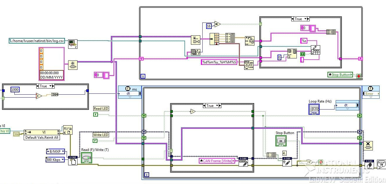

We adapted the LabVIEW VI’s provided by Stratom for our data logger. Firstly an X-CAN session is established between the MoTeC and the myRIO. The options here are straightforward, a bus speed is selected, in this case 500kbps, and the desired MXP adapter slot B chosen. The X-CAN session out is then transmitted to the main while loop. As can be seen in the code snippet shown in Figure 3 the X-CAN session will be stored to a cluster, which takes the form of a CAN frame. Each frame contains eight bytes of data, two bytes per channel (sensor). This is used as a high level function for the reading and writing of CAN data for the CAN device. The CAN frame is then passed to a custom sub VI for processing and sorting.
Figure 3 – X-CAN session establishment

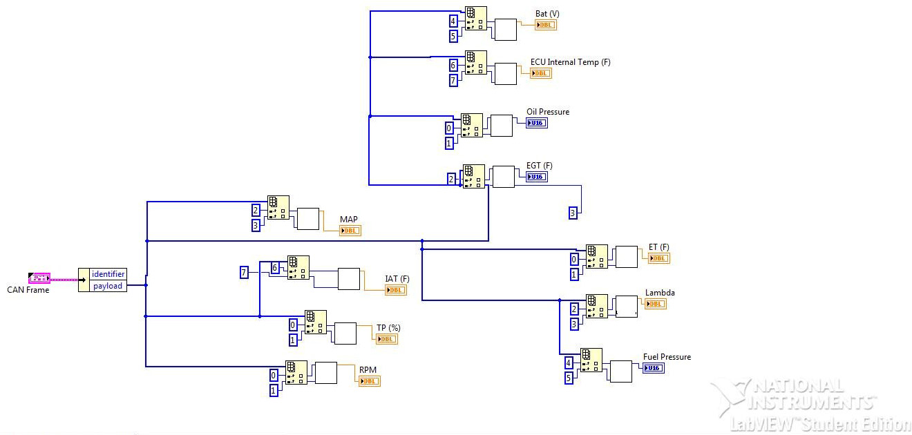

The unbundled can frame is passed to a case statement, which makes use of the decimal representation of the identifier. There are five cases defined, with the default being used to ensure all LEDs on the myRIO are switched off. This has been done as in the other cases they have been programmed to turn on when in receipt of a specific frame. The remaining cases are for the four frames of data (1520, 1521, 1522, 1523). LED0 will be illuminated in receipt of CAN frame 1, LED1 for frame 2, LED2 for frame 3, LED3 for frame 4.
The payload is passed to an indexed array, such that the relevant bytes of data can be extracted. In this case, CAN frame 1 has been sent, with its payload being indexed to output bytes 0, 1 which will be passed to a calculation state which will output the wheel speed as shown in Figure 4.
Figure 4 - Sorting bytes
The two bytes of data taken as being CAN HI and CAN LO are combined, with the output scaled based upon a factor which has been provided by the company MoTeC in their user manual. The final result is a DBL representing the speed, shown in Figure 5.
Figure 5 - Converting to real value
The same process is applied to the other channels. Each processed using this same method; the only difference will involve the scaling factor used, - fortunately this is provided for each channel type by MoTeC.

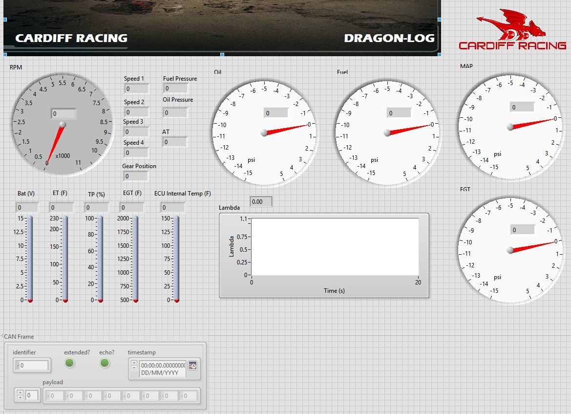

Figure 6 shows the user interface, which has been designed to allow the user to view the data clearly and simply. Wheel speeds are displayed using gauges, temperatures with thermometers and CAN frames with data displays. The ability to view live data has proved highly beneficial, enabling any immediate problems (such as overheating) to be identified early. The greatest benefit will come from post analysis of the stored data, as a thorough investigation can take place to characterise overall performance.
Figure 6 - LabVIEW front panel
A producer and consumer architecture was adopted – which was important to ensuring data integrity. The queues used to transmit data between sections of our code provide a buffer - preventing data losses when the data cannot be read/stored fast enough.
