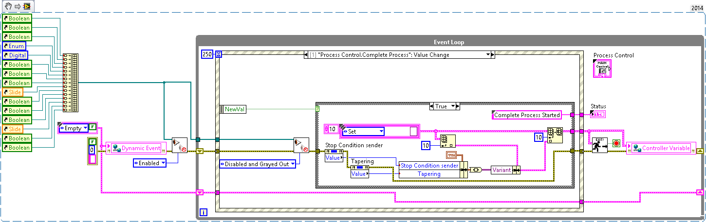

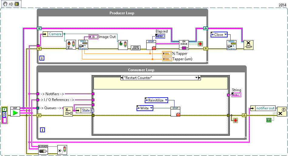

This system involves placing the optical fiber in two supports mounted on rails that can move linearly with micrometric displacements performed by motors which are controlled through LabVIEW. Simultaneously, the fiber is exposed to a burner used as a heat source by raising its temperature around 1250 ° C, it allows to reach a point at which the fiber can be deformed and thinned by the tension exerted on the ends.
The system was characterized to handle and choose the thickness at which you want to reduce the fiber.
Using NI Tools we reduce the time to design and to program the system and we spend more time doing test. we use LabVIEW because the software is very easy to use and because is versatile. the NI myRIO is able to control some different process in a little time, it allow us to control the final diameter and the final lenght of the fiber optic.
