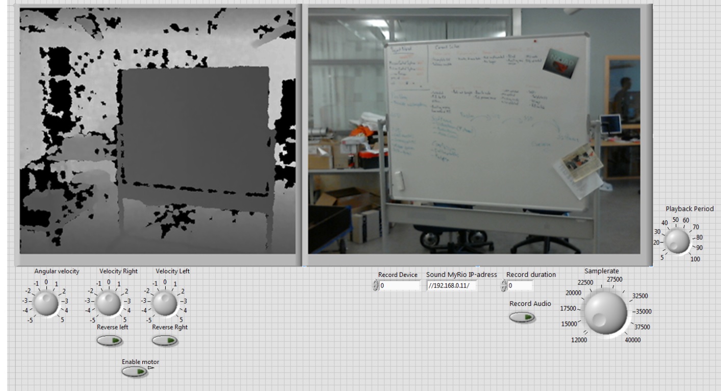

The goal of this project has been to create a remote and mobile platform for vision
acquisition where processing and planning of action can not only be done onboard but also on a
remote computer delivering possibilities of multiple implementations. This is achieved by the
streaming of both depth information and dual RGB channels. The steering is controlled by two
stepper motors which
MyRio x2
From the front panel the motors can be
controlled and the two VI’s running on the
MyRio’s also stream the image descriptors to
the front panel VI running on the computer. A
capture of this front panel is presented below.
From this system there is now easy to further
dive into the “world of machine vision”.
