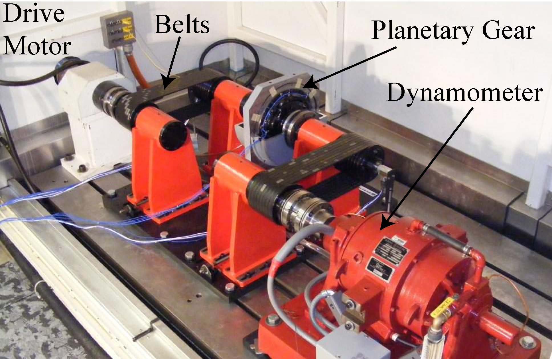

Figures 3 and 4 show the spinning test configuration. The planetary gear is driven by a 150 hp AC drive motor not shown in the photograph (off to the upper left). A 150 hp dynamometer (lower right, red) is used to apply load. The planetary gear is offset from the motor/dyno axis by belts to allow for instrumentation access (slip rings).
In these experiments the planetary gear speed is incrementally increased through its operating range. Data is acquired at each incremental speed. Twenty-one accelerometers and four encoders are simultaneously sampled. Vibration levels of each gear component are analyzed throughout the sweep to find natural frequencies and mode shapes. There are many natural frequencies excited by multiple harmonics of the meshing teeth. LabVIEW order tracking is used to separate out the vibration levels to understand the data.
Figure 3: Spinning Test Configuration |
Figure 4: Spinning Test Schematic |

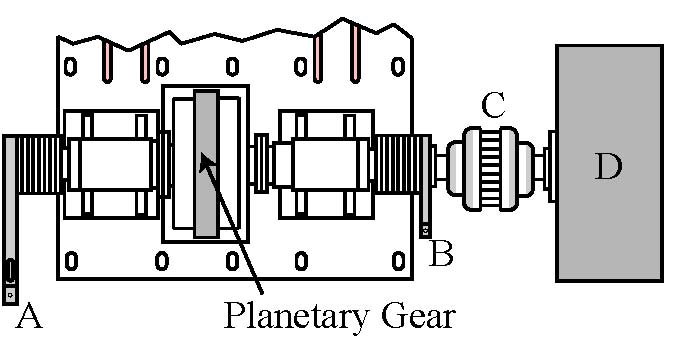

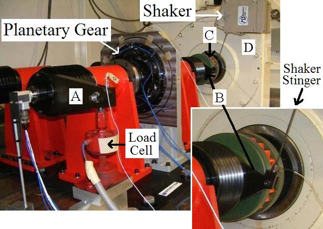

Figures 5 and 6 show the modal test configuration. The planetary gear is not rotating during these experiments. Rather, a static torque is applied while a modal hammer or vibration shaker excites the loaded system. The vibration shaker can apply several useful excitations. The following list outlines the different modal testing methods and their advantages. The first four methods use transient post-processing techniques, while the last method uses steady state techniques.
1. Impact (easy and mobile)
2. Chirp (shaker, broadband, control of excitation range)
3. Random (shaker, broadband)
4. Sweep (shaker, greater energy at each frequency)
The shaker sweep method was successfully used to match experimental predictions with an analytical model. LabVIEW control was an important aspect of these experiments. While recording data, LabVIEW monitors the actual input force measured at the shaker and uses a proportional controller to scale the applied voltage amplitude at the subsequent frequency step. This technique allows constant force excitation across a wide range of frequencies.
Figure 5: Modal Testing Configuration | ![]() Figure 6: Modal Test Schematic A – load cell arm B – modal arm C – compliant coupling D – torque actuator |

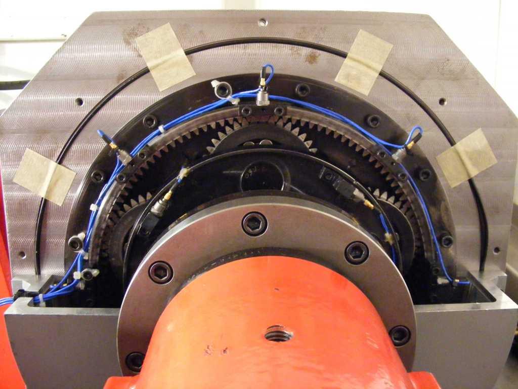

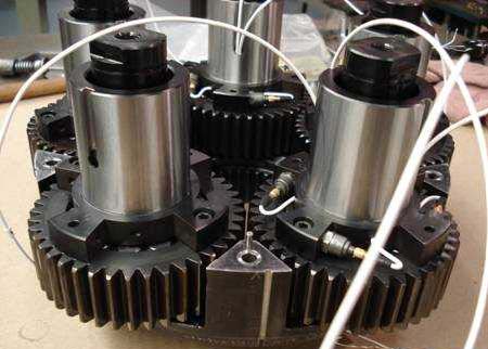

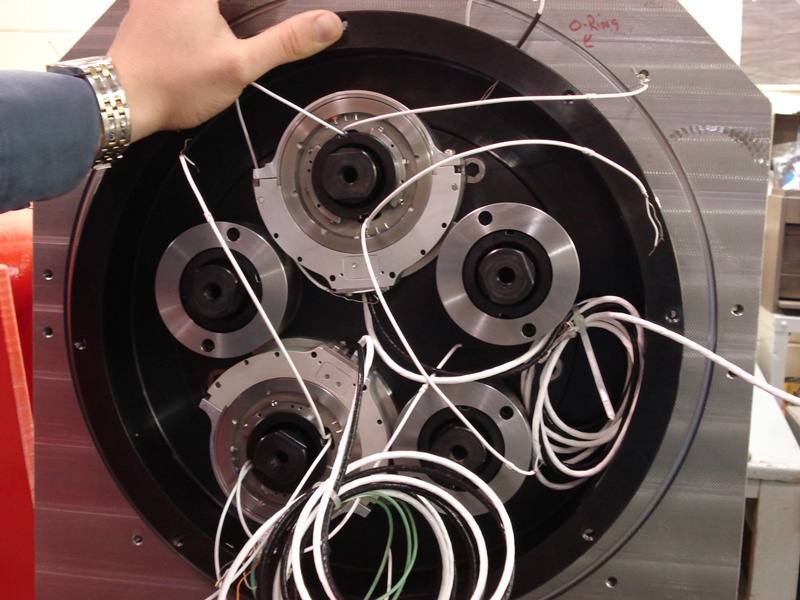

Twenty-one accelerometers and four encoders simultaneously track the motion of all planetary gear components during spinning tests. Torque is monitored at the drive motor and dynamometer shafts. An analog tachometer signal is measured at either the input or output shaft, although the encoders accurately measure gear speed and mesh frequency.
Similar instrumentation is used in both spinning tests and modal tests. Rotational and translational vibrations of rotating bodies (carrier, sun gear, and two of five planets) are measured using four tangentially-mounted accelerometers. The sensors are rigidly connected to the gear bodies near the meshing teeth to ensure measurement reliability. Figure 7 shows the tangentially-mounted carrier accelerometers and radially-mounted ring gear accelerometers. Figure 8 shows the accelerometers mounted to the planet gears.
Figure 7: Accelerometers Mounted Directly to Ring Gear and Carrier |
Figure 8: Accelerometers Mounted to Two of Five Planet Gears |

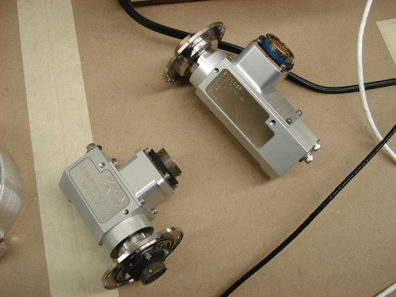

Slip rings are used to transmit data from rotating gears to the DAQ system during spinning tests. The rotating sun gear and carrier are equipped with the end-of-shaft slip rings shown in Figure 9. Signals from planet gears—which rotate on two axes simultaneously—must pass through two slip rings. Figure 10 shows the planet slip rings on the two instrumented planets that transmit data to the carrier reference frame before they pass with the carrier signals through the carrier slip ring to the DAQ system. Each slip ring is equipped with an encoder that tracks the instantaneous gear position necessary for post-processing that calculates rotational and translational vibration.
Figure 9: 10-Ch Sun Gear Slip Ring with 512 ppr Encoder and 36-Ch Carrier Slip Ring with 1024 ppr Encoder | Figure 10: Two 8-Ch Planet Slip Rings with 1024 ppr Encoder Mounted to Planet Gear Adapters in Carrier |

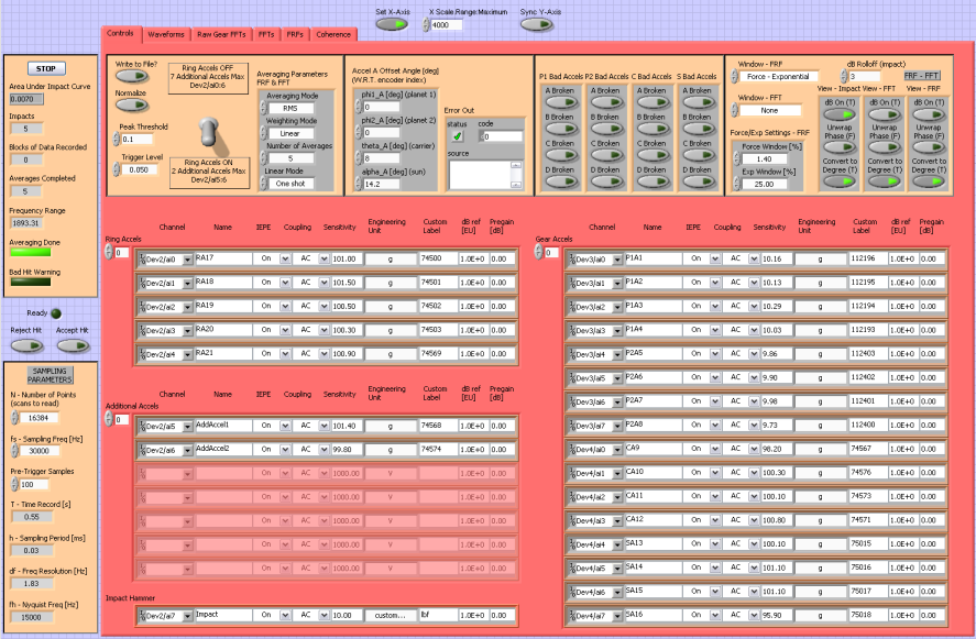

Impact testing
Most of the front-end user programs use tab controls to organize data. Figure 11 shows the initial impact testing screen with all of the user controls. In this screen, the user can choose to:
1. Write the acquired data to file
2. Adjust the trigger level
3. Set the averaging parameters
4. Identify any broken accelerometers
5. Select windowing
6. Set the sampling parameters
7. Specify channel properties (excitation, sensitivity, label)
and more.
Figure 12: Impact Testing Controls

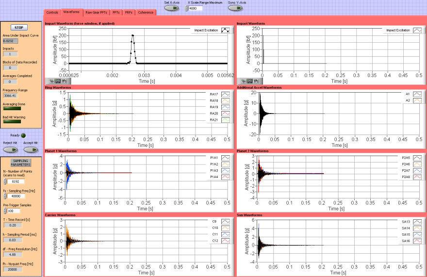

Figure 13 shows the time-domain waveforms collected during impact testing. The top two traces show the impact signal on two time scales. The remaining graphs show all of the impact signals. A Bad Hit Warning light indicates if there is a double hit detected by a custom subscript. After inspection, the user chooses to acceptor reject the hit.
Figure 13: Time Traces of the Impact Waveform and All Accelerometers
Figure 14 shows the FFTs of all signals. System dynamics and natural frequencies are easily identified. A custom subscript calculates the rolloff frequency of the impact FFT (which can be viewed before accepting or rejecting a hit). A similar tab control showing the frequency response functions (FRFs) for all of these signals can also be viewed. The final tab shows the coherence of all signals. A video demo of an impact test is provided.
Figure 14: Calculated FFTs for Gear Rotation and Translation with the Impact Signal FFT and Two Additional Accelerometers

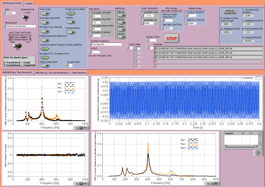

In the output tabs, the user can view the output spectrum acceleration or displacement from each individual accelerometer or in gear degrees-of-freedom (rotation/translation).
Figure 15: User Interface to Calculate Vibration RMS Response for All Degrees-of-Freedom in One File
Figure 16 shows the output of a file that processes one gear degree-of-freedom (in this case, carrier rotation) in multiple files (in this case, 3).
Figure 16: User Interface to Calculate Vibration RMS Response for One Degree-of-Freedom in Multiple Files

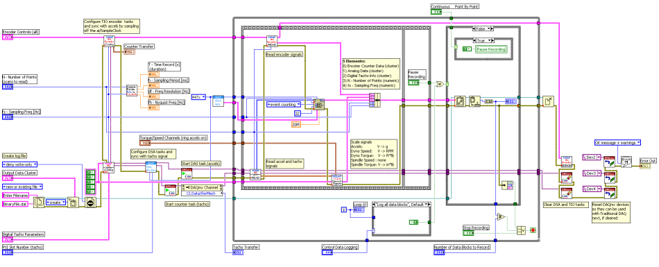

Few programs are small enough to show a block diagram, but the program which logs spinning data is one because the data is not directly analyzed and plotted in this program. Figure 17 shows the block diagram for spinning test data collection. The AI sample clock is used as the timebase for encoder sampling to synchronize data acquisition across multiple data acquisition cards (3x 4472 cards and 2x 6602 cards).
Figure 17: Block Diagram of Spinning Test Data Logging Code

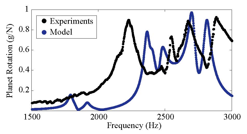

The experimental results are compared with an analytical model [6]. In modal testing, twelve of the fifteen natural frequencies agree within 5% error, the other three within 15%. All of the natural frequencies predicted by the model are accounted for in experiments. In addition to the natural frequencies, FRFs, which include mode shape information, also agree well between the model and experiments. Figure 19 shows a comparison between planet rotation that is measured experimentally and predicted by the model. This data shows solid agreement between experiments and a model for such a large multi-degree-of-freedom system.
Figure 19: Planet Rotation Measured Experimentally and Predicted by and Analytical Model

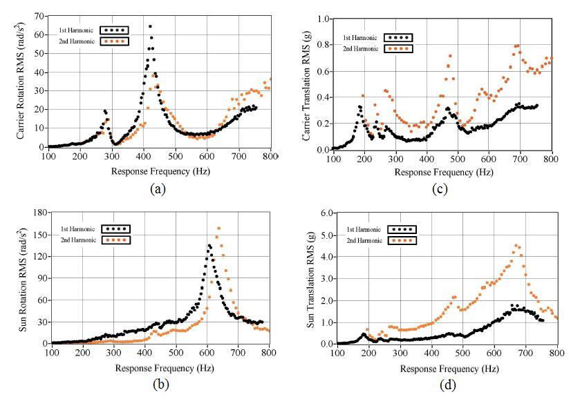

Spinning tests highlight the need to measure the vibration of each gear independently. Figure 20 shows the dynamic response of the carrier and sun gear in rotation and translation. LabVIEW order tacking is used to isolate the response at the 1st and 2nd harmonic of mesh frequency. The important information contained in these graphs lies in their differences. The data in all four of these plots is collected in the same test. If one were to measure carrier rotation only (Figure 20a), natural frequencies at 270 Hz and 420 Hz would be measured. The 610 Hz natural frequency in sun gear rotation (Figure 20b), however, would be missed entirely. Similarly, the response between the rotational degrees-of-freedom (Figure 20a, b) and translational degrees-of-freedom (Figure 20c, d) is significantly different. This research shows the importance of considering the vibration of all planetary gear components, not just a small subset of the system.
Figure 20: Planet Rotation Measured Experimentally and Predicted by and Analytical Model
As indicated in Figure 20 and the discussion above, there is a qualitative difference between rotational and translational response. In fact, analytical research shows that the modes associated with a planetary gear can be classified into three types: rotational, translational, and planet modes [6]. As the names suggest, the natural frequencies within these mode types are dominated by rotational, translational, and planet only motion respectively. This experimental research has been used to strongly support the classification of planetary mode types. Again, much more information is found in the papers published from this research, listed below. A brief summary of the primary contributions follows:
