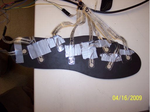

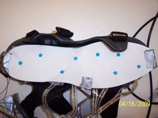

As mentioned, eight sensors were used to measure pressure on the bottom of the foot. These flat sensors act as resistors that change the value of their resistance based on the amount of pressure being applied. The sensors were secured inside a shoe insole to measure important points, such as the big toe, the heel, the arch of the foot, etc. The insole can then be placed into a shoe for the user to wear.
The output wires of the eight sensors are run from the shoe to the project box, which is attached to a belt for the user to wear around the waist. Inside the project box, each sensor input is connected to an op-amp that converts the input resistance to an amplified voltage in the range of 0V to about 3V.

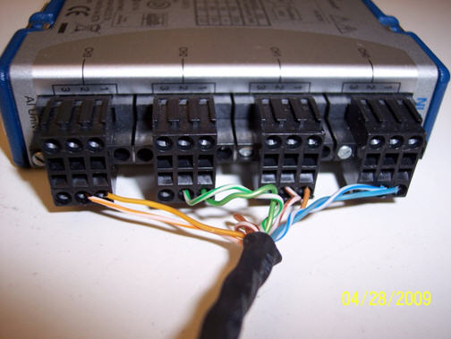

The data acquisition board had only four input channels for our eight sensors. Therefore, another circuit can be found in the project box, which switches between the set of sensors being read. At any given time, only two or three of the eight sensors are being read. The set of sensors being read changes about every 100ms, based on the settings of a timer circuit. The project box has four outputs to the data acquisition unit, one telling which set of sensors is being read, and three more giving the output of the amplified sensors.
The National Instruments data acquisition board and its battery pack are also attached to the same belt as the project box. As described, a wireless link is set up between the data acquisition unit and a laptop in an ad-hoc 802.11b Wi-Fi network. The laptop has National Instrument's Lab View software installed on it, and a new program developed by this semester's team. The software displays a diagram of a foot, with points corresponding to where the sensors are located that change color intensity based upon the amount of pressure on the foot, all in real time. After the test is completed, all the collected data for each sensor is displayed on a graph and is saved to a text file.
