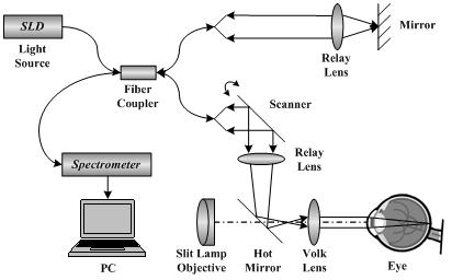

In our system, a FD-OCT is constructed for the imaging of the retina of the human eye. (Fig.1)
A broad band light sources beam is employed as the low coherent light source. The incidence was split in a fiber coupler and focused on the background of the eye and on a reference mirror, respectively. The reflected beams are recombined in the fiber coupler and interfere there, coding the information of the retina in the interferogram. Afterwards, the interferogram is recorded by a grating-based spectrometer. The spectrometric data was taken with a line CCD camera (Aviiva e2V). Together with NI IMAQ PCI-1428 image acquisition card, the data for each A-scan is recorded and then processed for visualization by a custom-designed program written with Labview.

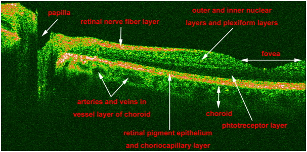

Each shot gives us on depth scan (A-scan) of the eye, with two galvanometric scanning mirrors the beam is scanned across the surface of the retina to record A-scans at different positions to reconstruct the 3-D morphological structure of the retina in vivo (Fig. 2).

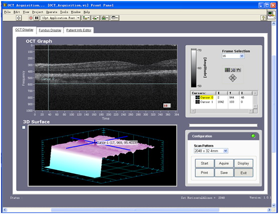

All of these parts are controlled by NI Labview 8.5. The post processing is also done with Labview. Furthermore, we also designed a Labview based, custom made, graphical user interface, allowing an easy access to the system and suiting the demands of medical professionals. (Fig.3)

Fig. 1 Diagram of the FD_OCT system.
Fig. 2 Our OCT imaging result revealed the biological structures of the human retina.
Fig. 3 The FD-OCT GUI.
