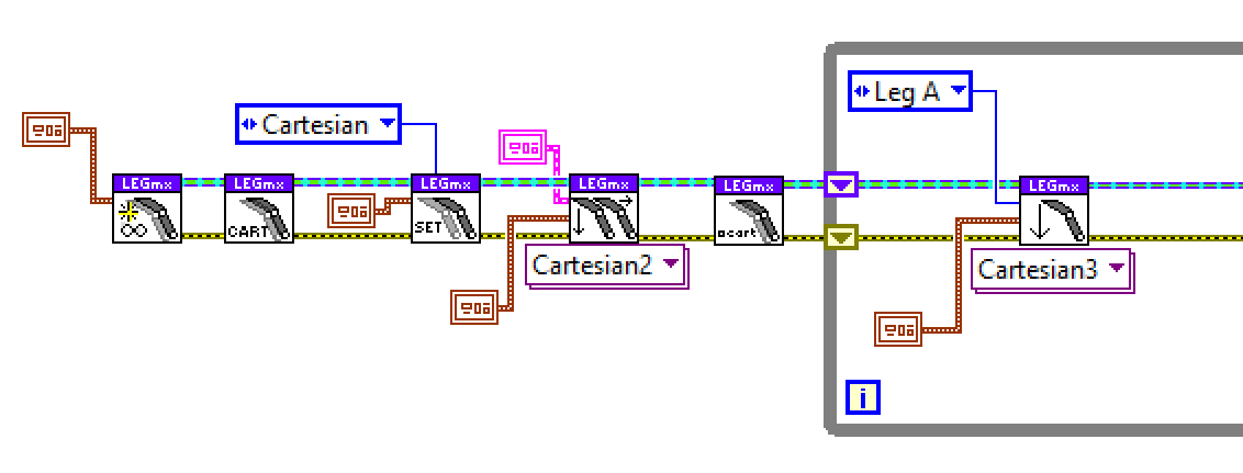

By far the most extensive part of this project is the software. Co-ordinating 18 motors to achieve a good quality overall movement is not easy and requires well structured code. Below is the overall software architecture.
The software is divided across the three hardware platforms on the hexapod; The FPGA, RT Processor and Development Computer.
The FPGA is used for the laborious mathematical calculations for needed to perform inverse kinematics (converting XYZ robot leg postions to leg join angles, read more about that here), and low level digital signal generation. This frees up the RT Processor to do the higher level work; in this case generating the list of XYZ positions required to make the robot walk, or calculating desired body orientations based on sensed orientation.
To organise the code controlling the XYZ positions of six legs, I build my own object oriented set of drivers, humourous referred to as LEGmx. They make the process of writing 6 XYZ motor positions (that's 18 values) to an FPGA VI much simpler.
Essentially the FPGA acts almost like a bespoke hardware driver for the RT processor, easily performing the hundreds of calculations needed for control, saving millions of operating cycles for the RT processor. This kind of hardware setup is absolutely ideal for robotics applications, and is one of the key benefits of using the sbRIO.
A VI on the development computer runs a 3D simulation of the hexapod (based on imported STL files), and animates it based on the real angles sent from the RT processor via a global variable. The VIs running on the RT Processor are controlled via Front Panel Communication from the development computer.
