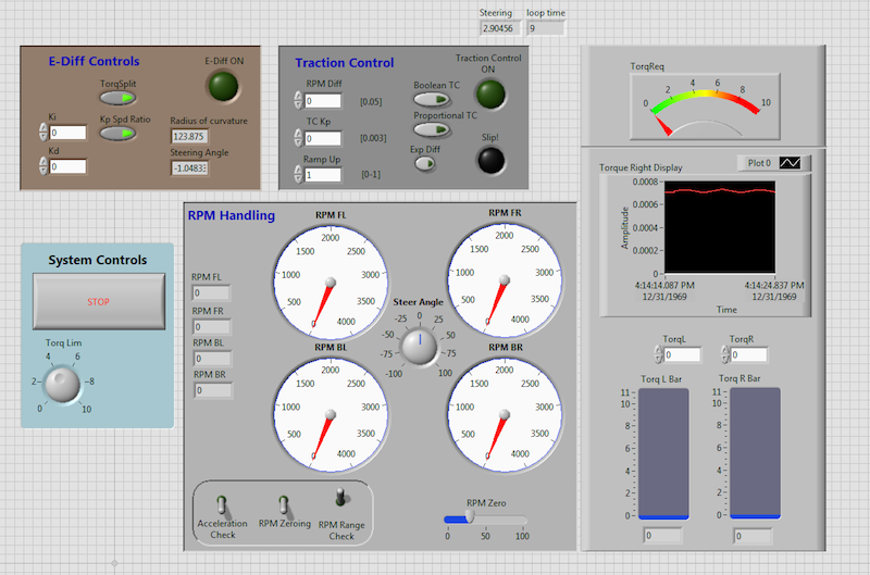

NI LabVIEW software combined with the cRIO has been highly effective for the development of our flywheel-electric vehicle. The hardware and software is easy to set-up, learn, has many built-in tools, and works well in stand-alone applications. Most importantly, the National Instruments microcontroller system and its components are very modular. All of these features combined with easily custimizeable GUI's (Graphical User Interface) to work with the control systems make NI hardware/software packages very attractive solutions for prototyping. Figure 3 shows our vehicle controls GUI.
Figure 3–First iteration of vehicle system user interface

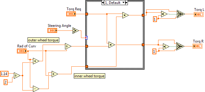

The vehicle has numerous sub-systems: the traction control system (4 sensors), the electronic differential system (5 sensors), and the flywheel system (multiple current, voltage, vibration, and temperature sensors). As with typical prototypes, the demand for additional sensors and input/output (I/O) channels has increased beyond expectations. Labview microcontrollers allow us to add I/O modules of many different types (voltage, current, analogue, digital, etc.) with very little additional cost to the entire system. Additionally, when a module is added and our system expanded, no new code or modifications are required to maintain all of the functionality of the control code that was already written. Figure 4 is a highly-simplified block diagram of the control loop that will be employed on the INSTAR kart prototype and Figure 5 shows a sub-VI of the electronic differential sub-system.
Figure 4–Overview of the traction, differential, and flywheel control systems
Figure 5–Sub VI component of the Electronic Differential System
