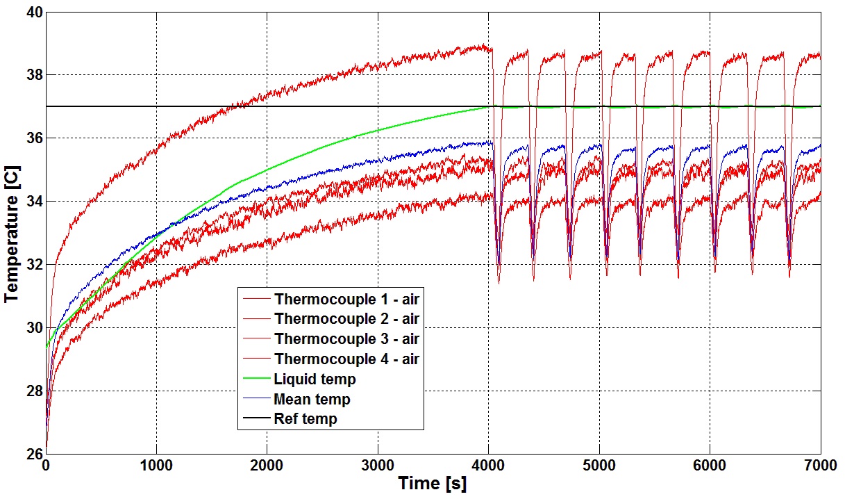

The results obtained for in vivo patient's data with the real-time in vitro testbed satisfy the condition of a maximum relative error set at 5%. We have to bear in mind that we are dealing with very fast control loops. LabVIEW executes one cycle for all the input/output signals in a time period of 5ms (200Hz). It is much higher than the one in most industrial control systems. In addition, the system is highly non-linear and depends on the external conditions such as compositions of the medium that can vary significantly with the plasma used and/or the mixing of additional substances such as Red Blood Cells (RBCs). Moreover, it also varies with the properties of the equipment and experimental variability such as diaphragm age, external temperature that are difficult to predict and to model. Examples of some flows obtained using our in vitro testbed are presented in Fig.6 for the controlled flow and in Fig.7 for the controlled temperature.
Fig.6. Examples of reproduced flows by the in vitro testbed.
Fig.7. The control results of the medium temperature.
