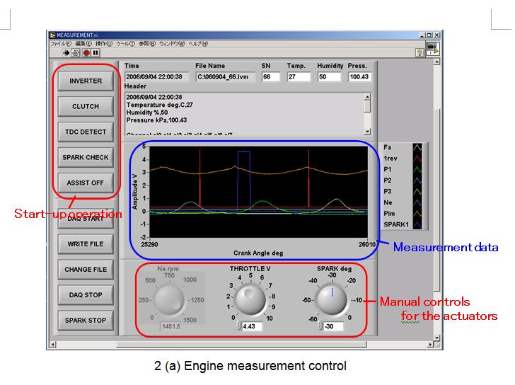

To analyze and evaluate the effects that differences in fuel gas compositions have on engine operation, various data during engine operation such as fuel flow, airflow, temperatures of various engine parts and pressure are measured. For future analyses, it is desirable that measurement is synchronized with the engine crank motion. Sampling rates should be set flexibly, for example, rapidly changing signals such as pressure should be sampled for each crank angle (9000 Hz at the rated engine revolution of 1500 rpm) while slow-changing signals such as temperature should be sampled for each crank revolution. Since the output voltage range varies depending on the sensor amplifier, it is desirable to set the range for each channel to obtain accurate measurements.
<Engine operation control>
When an engine is started, the clutch needs to be engaged, the cell motor rotated, and the clutch disengaged once the fuel is supplied. Also, during operation, it is necessary to adjust airflow, fuel flow and ignition timing to the predetermined experiment conditions by operating the actuators such as the throttle, mass flow controller and spark plug. Operating multiple devices while monitoring the engine operation during the experiment places a heavy burden on the testers, and improvements in efficiency are desired.

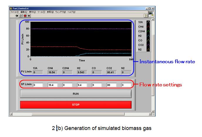

Simulated biomass gas fuel is generated in mixtures of arbitrary ratios by independently monitoring and controlling six types of gases in canisters (CH4, C2H4, H2, CO, CO2, N2) and city gas 13A with seven mass flow controllers. Controlling the seven units simultaneously is complicated.

For the engine measurement control system, the PXI-controller (PXI-8176), A/D board PXI-6071E, D/A board PXI-6733 and counter board PXI-6602 were used. For measurement, the sensor output data are sampled per crank angle using the A/D board PXI-6071E, based on the signal from the rotary encoder. For operation control, actuators such as the clutch, cell motor, throttle and mass flow controller are operated using the D/A board PXI-6733, and ignition signals are generated using the counter board PXI-6602. So NI products were used for the I/O signals of all devices operated during the engine operation, allowing the engine operation and measurement to be controlled via a PC.
For the simulated biomass gas generation system, an off-the-shelf desktop PC, the PXI-chassis, A/D board PXI-6031E and D/A board PXI-6733 were used. The flow rate of each gas composition is controlled with the voltage output from the D/A board PXI-6733, and the actual flow rate is measured with the A/D board. The system enabled the simultaneous operation of seven mass flow controllers with a PC, which made it possible to control the mixture ratios of seven gas compositions (13A, CH4, C2H4, H2, CO, CO2 and N2).

Fig. 2 shows the front panel of the program used for the experiment and analysis. Fig. 2 (a) is the engine measurement control program that measures the engine operation data, after the engine start-up sequence is conducted automatically and actuators are controlled manually to the experiment conditions. Fig. 2 (b) is the front panel of the program that sets the simulated biomass gas fuel mixture ratio. The flow rates of seven gases can be set and monitored individually. The measured data are analyzed for engine performance (output, thermal efficiency and variation coefficient of the output) and combustion characteristics (combustion start time and combustion period) with the analysis program in Fig. 2 (c).
