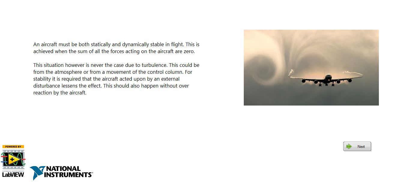

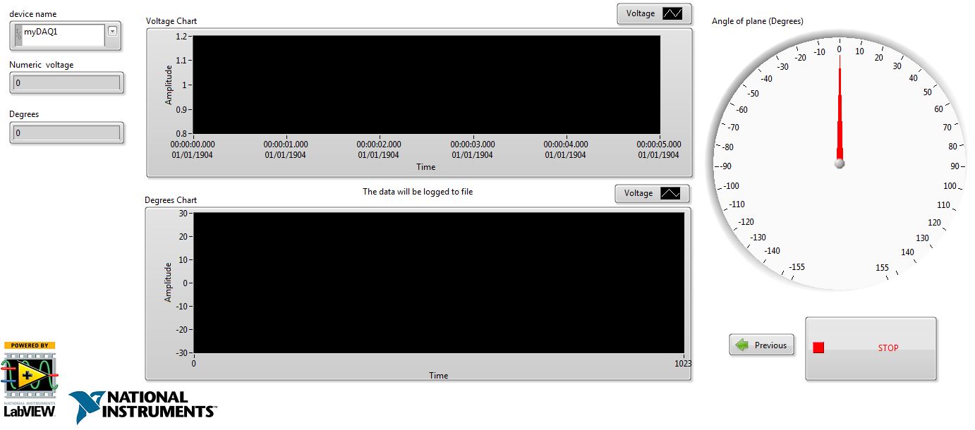

I am studying Aerospace engineering and this project looks at using the NI-MyDAQ and LabVIEW to lead students through a tutorial about aircraft stability in Yaw.
