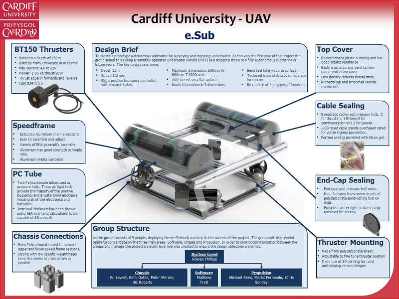

The Submarine itself was designed from scratch for this year of the project by the
team of mechanical students. The design brief was to create a neutrally buoyant
chassis and hull that could contain all the electrical components and battery
power supply. This was achieved through multiple design iterations using the
CAD software Solidworks and then built to this design.
In order to reduce the number of moving parts on the submarine and hence
reducing the waterproofing requirement of the project, it was decided that a
vector thrusting arrangement would be used. This meant having 4 thrusters
arranged at 45 degrees to the orientation of the submarine and a single
central vertical thruster. This gives the submarine 4 degrees of freedom with
complete movement in the XY axis and depth control in the Z axis. To ensure
that the thrusters moved the submarine in the desired direction, feedback
sensors were used to act as process variables in PID control loops within the
LabVIEW Control code on the myRIO. This ensured that any imbalance in
the thrusters due to water flow would be accounted for.

Cardiff e.Sub Poster 1
