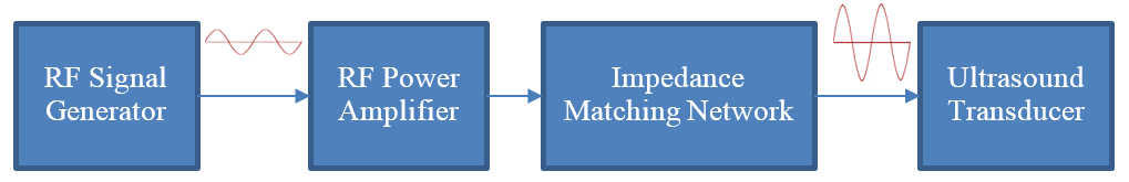

Modern HIFU systems are cumbersome and expensive. Typical system setup requires multiple components:
  Figure 2. Typical high-intensity ultrasound system setup.
The RF Signal Generator provides a low power signal of a specific waveform (normally sinusoidal) to the RF Power Amplifier which takes the input signal and amplifies it to match power requirements of the transducer. The frequency of operation is 1.10 Mhz and delivering hundreds of watts of power.

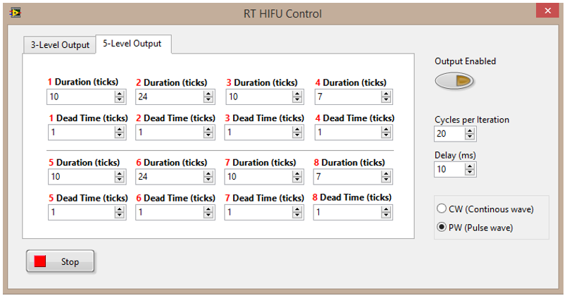

NI myRIO is used to generate the five control signals with a precise timing, utilising a high speed on-board FPGA.
Timing can be adjusted at runtime using the user interface (UI) created in LabVIEW.
Figure 5. User Interface.
