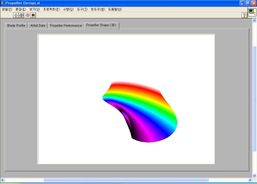

4. Propeller Shape (3D)
The final design of the propeller geometry shown in 3D. It is possible to use the mouse to see while rotating. The result of desigh -Chord of blade section, thrust, torque, efficiency will be saved as files Result_r_chord_beta.txt and Result_speed_thrust_torque_efficiency.txt each file.
