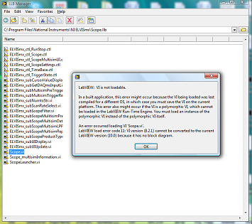

Could you please let me know how can I open the Scope.vi inside of Scope.llb.
when I try to open sope.llb/scope.vi file, It shows the following error:
Hello All,
I have used three different version of 2009, 2010 and 2014 and all have the same following error,
When I want to open the "Scope.vi" via LLB Manager, it shows the following error:
LabVIEW: VI is not loadable.
In a built application, this error might occur because the VI being loaded was last compiled for a different OS, or with CPU features, such as SSE, that this target does not support. In this case you must rebuild the application for the target OS and make sure SSE compiler setting in the build specifications match the target platform. This error also might occur if the VI is a polymorphic VI, which cannot be loaded in the LabVIEW Run-Time Engine. You must load an instance of the polymorphic VI instead of the polymorphic VI itself.
An error occurred loading VI "Scope.vi"
LabVIEW load error code 11: VI version (8.2.1) cannot be converted to the current LabVIEW vesion (14.0) because it has no block diagram.

Hello alizar,
I'm very sorry for the delay in response from us. I was having the same error as you when trying to open the Scope.vi from the library, but it has been fixed by downloading NI ELVISmx 14.0, which you can do from the link below:
Hello CBond,
I have just downladed the new version, NI ELVISmx 14.0 and install it in my system but still it says same error and I can't open scope.vi file,
As I mentioned this is the error it shows me:

Finally, after long process, the NI people help me to find and downlaod the new version of ELVIS, called NIELVIS 15 which is able to open the Scope.llb file, the prevoius file was issued at '6/27/2014' but the new version of ELVIS 15 is able to open.
