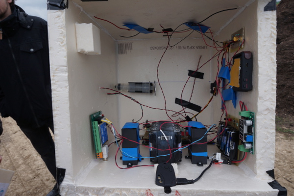

The result of all their efforts is a beautiful “baby” of 2.3 kg weight (Figure 1).
Figure 1: Internal and External View of the payload

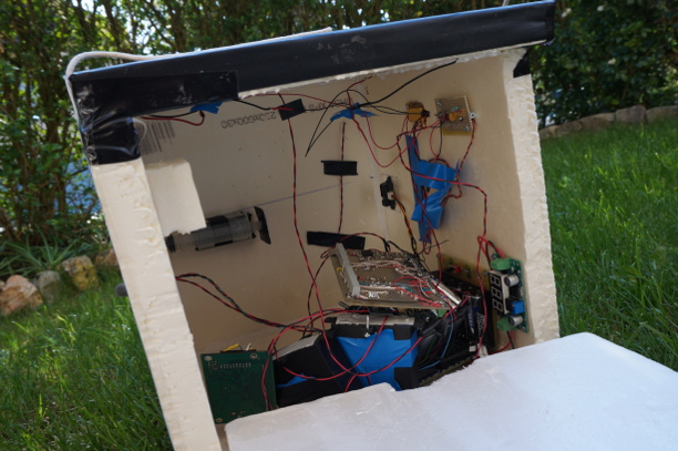

A new trip to “Boeurs en Othe” has been scheduled to find our payload. We met the farmer who found our payload. We decided to open the structure together to see all experiments made by our students. And, it is the drama! A picture is worth a thousand words:
Figure 2: Inside the payload
Did we firmly attached all the electronic cards??? Seeing this "mess", we started to doubt if we had any recorded data ... Did everything remain in place during the flight ?
Finally, all data were readable. We were able to extract the log file containing all the data. (the log file is attached :
