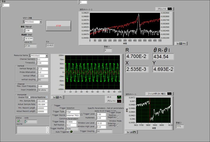

Fig. 3 shows a frontpanel of the prototype system. The spectrum in the right upper box shows theNMR signal. The peak is due to fluorine which is originates from the targetcell and the support frame made of PCTFE. The noise to the signal was not smallto measure the polarization of HD.
In the prototype system, 100 k samples of digitized NMR signal heights areaccumulated and averaged in each magnetic field setting. In this averagingprocess, statistical errors are decreased. It should be noted that the majorpart of noises come from thermal fluctuation. In order to obtain a high S/N ratio, it is important to accumulate anumber of samples within a measurement period.
Fig. 2. Diagramof portable NMR measurement system
Fig. 3. Front panel of the prototype system. The window in theupper right shows the in-phase (I) and quadrature (Q) signals. The white peakis the NMR signal of fluorine in the upper graph.

Since the NMR signal measurement had succeeded in theprototype system, we bought a digitizer PXI-5142 (100MS/s 14bit), which is high-speedand high-resolution more than PXI-5114(250MS/s 8bit), and installed it. And thecodes have been redesigned for improvement of S/N ratio toward the practicaluse as follows.
As a result, a sampling speed in averaing process increases 100 k/s in theprototype to 1 M/s. The peakis NMR signal of fluorine in Fig. 4. The peak shape was improved as comparedwith in Fig. 3. In the conventionalsystem, connectors were changed ports in the instruments by changing thecondition. In the portable system, the operation instrument is switched by atab button on the LabVIEW.
Fig. 4. Front panel of the practical system. Lock-inamplifier, Oscillo scope, Frequency scope, and Network analyzer is changeableby selecting a tab and then activated a selected instrument without handlingconnectors.
