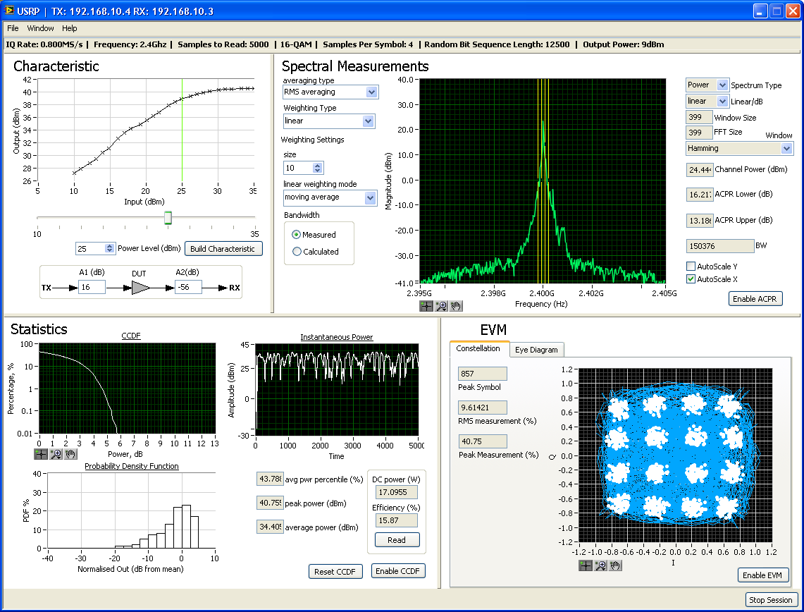

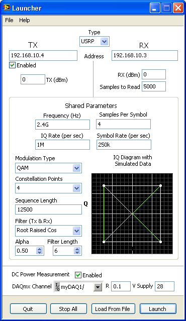

Below the launcher and receiver user interfaces can be seen. The application allows multiple 'Receivers' to be launched simultaneously to allow for data comparison.
Figure 1 - Application Launcher
Figure 2 - Main Application Interface
From the receiver, the launcher can be found using ‘Window >> Show Launcher’ and data sets saved and loaded under 'File >> Save/Load’.

Key features of the application include:
Power output/input characteristic
Spectrum analyser
Statistical Measurement
EVM & Eye Diagram
Efficiency
Other Software features
Fundamental Power Ouput/Input Characteristic
In this system, the first and most basic measurement is to measure the power characteristic at the fundamental frequency. This plots input power against output power revealing amplifier gain and the point at which compression occurs. This is generated automatically and then the transmitter can be adjusted to operate along this characteristic so that changes in the received waveform and efficiency can be observed.
Efficiency
A key concern of any RF engineer will be the power efficiency of their system. Here, the NI myDAQ has been used to measure the supplied DC Current (and therefore power) so that a measure of efficiency can be calculated. Changing efficiency can be observed by adjusting system parameters such as input power modulation or coding.
Spectral Analysis
An FFT is performed by the spectral measurements toolkit. ACPR is measured so to quantify any spectral regrowth which occurs, mainly as the result of waveform clipping due to amplifier compression.
Figure 4 - Spectral content before and after amplifier reaches compression
Statistical Analysis
In a digital RF communications system such as this , the instantaneous power developed by the system is not constant. The output power is rapidly changing as the output signal traverses the constellation. As efficiency and transmission quality changes dramatically as a signal traverses an amplifier's gain characteristic, it is interesting to perform a statistical analysis of a modulated wave to discover how much time a waveform spends at differing power levels. Key observations would be to see if the waveform spends too much time at inefficient low power levels or if the peak power levels push the amplifier too far into compression causing unwanted spectral emissions. CCDF is performed using the modulation toolkit.

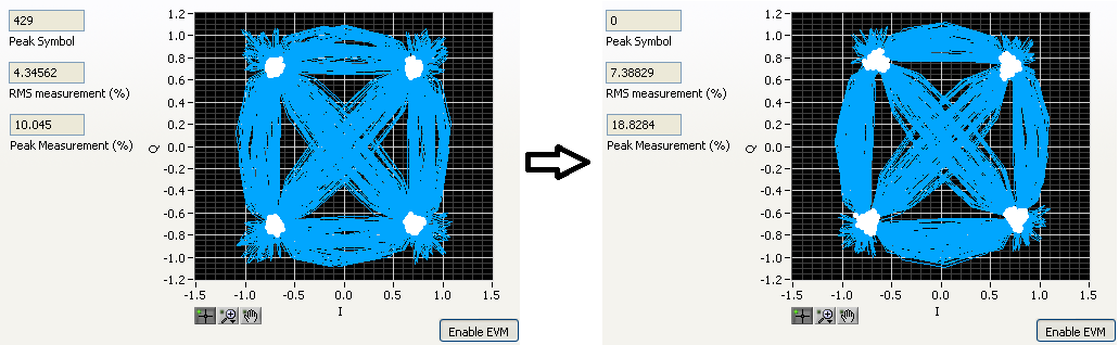

Error Vector Magnitude & Eye Diagram
Constellation diagrams, trajectories, eye diagrams and EVM measures are generated by the modulation toolkit. EVM provides a measure of the extent to which a received symbol is ideal and provides an insight into signal quality.
Figure 5 - Deteriorating EVM
