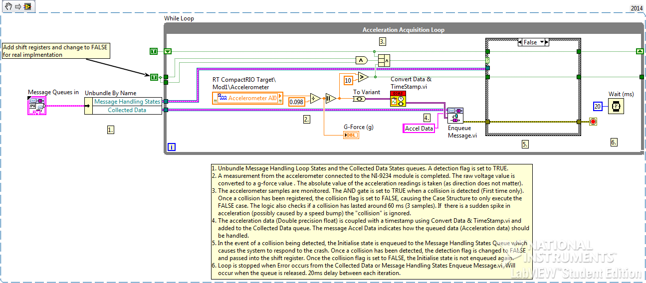

Acceleration Acquisition Loop
The Acceleration Loop is a data acquisition loop, acquiring accelerometer data frequently from a 608A11 accelerometer through the NI-9234 Module. Samples are collected 50 times per second (50Hz). Any accelerometer data collected is converted from a raw voltage reading to a useful acceleration reading measured in G-Force (1g = 9.8m/s^2). This measurement is then added to the Collected Data Queue where it can be written to file in the Message Handling Loop. The Acceleration Loop is also responsible for determining whether a vehicle collision has occurred, and if a crash has occurred; notifying the Message Handling Loop which can respond accordingly.
Figure 3 -Acceleration Loop Snippet

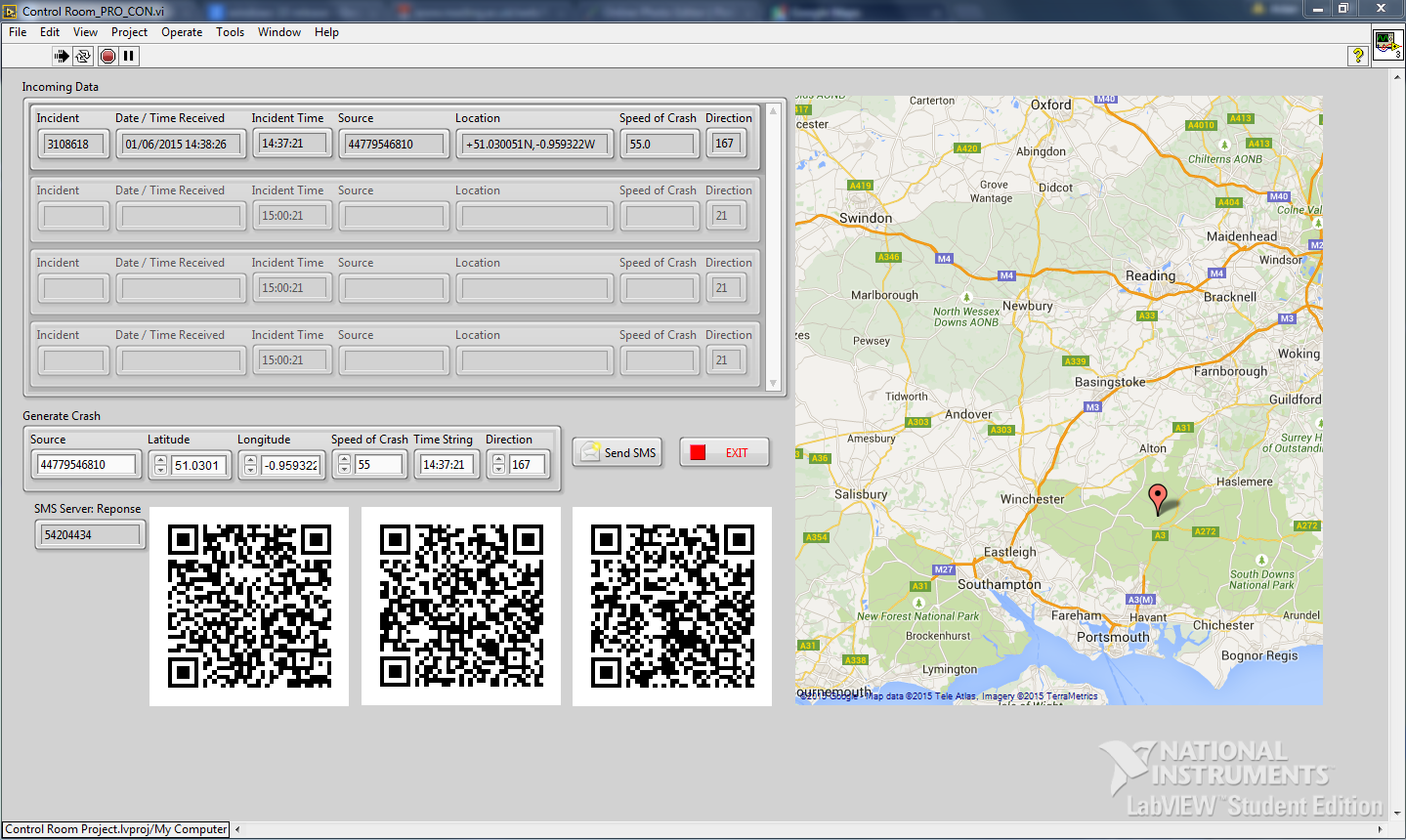

The Control Room application is an additional application used to demonstrate how an entire Emergency Crash Alert System or eCall system may work. The Control Room is used to receive incoming emergency crash alerts from ECAS systems that have been deployed into vehicles. Any SMS message data that is sent through the FastSMS service can be managed easily using this application, which displays vital crash information to the Control Room Operator such as the location, and last known position.
The Control Room was programmed using LabVIEW. Any SMS received by the FastSMS telephone number is stored as string information on the FastSMS server. The Control Room requests the information from the FastSMS servers using a HTTP API. A large amount of the code in this application is used to organise the string data received from the server into a visually clear and simple format.
The Control Room GUI displays tabulated data in addition to a map. In the event of a collision, the table is automatically updated, and the exact location an incident ID is plotted to the map. There is no limit of the number of incidents that the system can handle (and plot correctly).
Figure 9 - Control Room Front Panel
