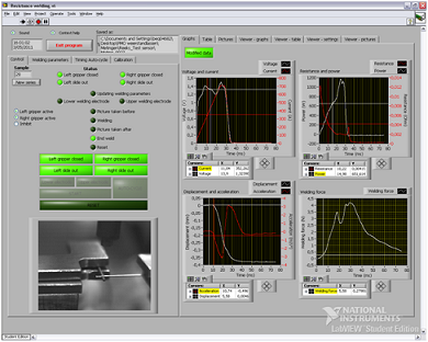

The program interface is easy to handle (at least if resistance welding means something to you), and is developed according to the requirements given by the welding engineers at Philips Lighting. It has basically two sides: at the left you see all tabs needed to control the machine, at the right all measured data are shown, including tabs for the Viewer.
Picture of the (translated) program right after finishing a weld

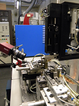

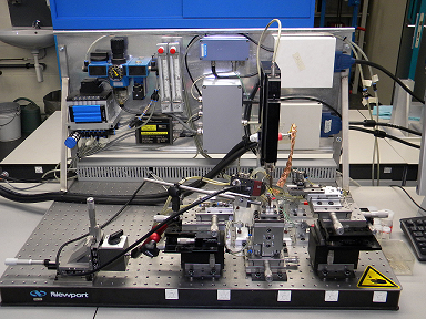

Here are some pictures of the machine:
Picture of the machine. In the back you can see the control board. Left is the welding power supply (not visible), to the right you can just make out the keyboard of the PC.
Closer look on the welding electrodes and the pneumatic components. The blue machine in the back is the welding power supply.
