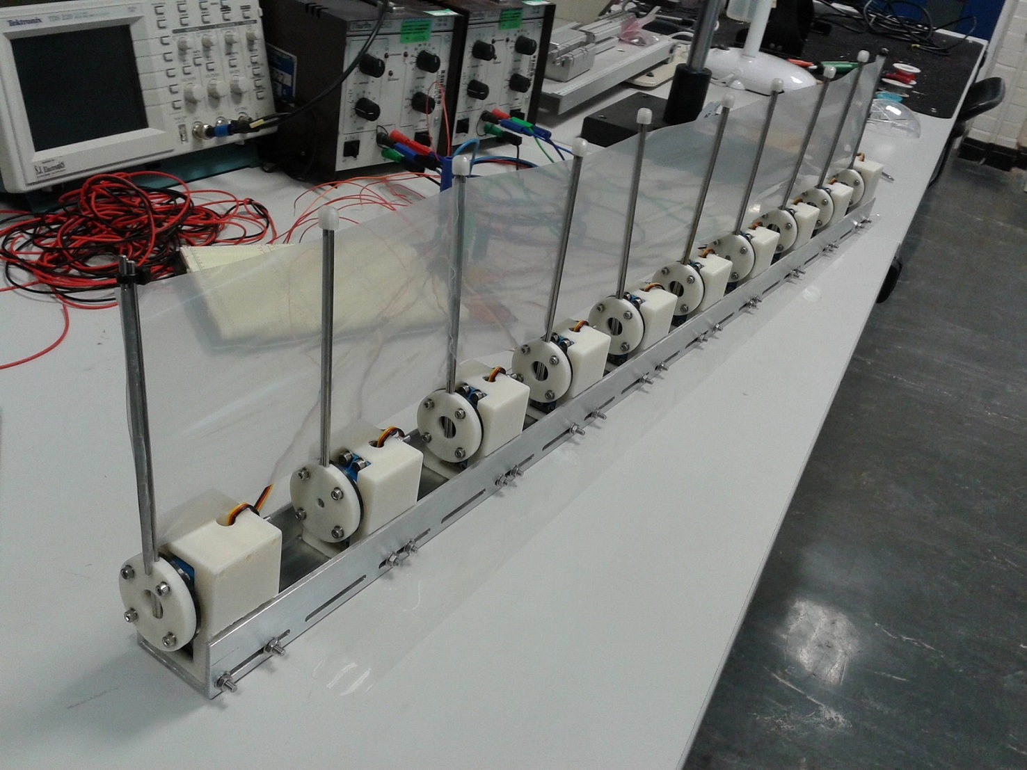

The spine assembly makes up the undulating propulsion system in the SquidROV, excluding the control electronics. It consists of ten servo motors mounted to a rigid central spine. The servo motors are a vital part of the propulsion system. For the SquidROV project the HS-5646WP servo from HiTec is used. It was chosen because it is rated IP67 (waterproof), is controlled digitally using a PWM signal, has high torque ratings and is reasonably priced. On each servo motor there is a set of stainless steel rays mounted to the arm of the servo, which can move in an arc of approximately +/- 40 degrees. Between each set of rays a thin silicone membrane is wedged and secured. This silicone membrane runs the length of the spine, forming one continuous flexible fin. When a travelling wave is generated along the spine by altering the angle of the various servos, the membrane will move and stretch, pushing the surrounding water in one direction and propelling the SquidROV in the other. A picture of the assembled fin can be seen in fig. 4, and a demonstration of the travelling wave can be seen in video 1 further down. Note that the fin is lying upside down in the picture, as the picture was taken in the laboratory.
Fig. 4: Spine assembly with ten servo motors and flexible membrane, upside down.

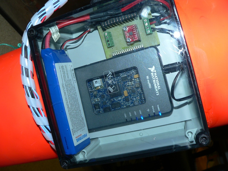

In addition to the various parts needed for the mechanical manufacture of the SquidROV, a second set of parts is required for the control system. The control system consists of the physical components required to create the control system for the SquidROV and the software developed. The overall schematic of the control system components can be seen on fig. 5. This figure shows the overall connections between the MyRIO, the servo motors, the battery and the gyroscope. (Note: The gyroscope is not utilized at this stage, but was included in the design to provide a platform for further development. See future developments for details.) A photo of all the components assembled within the box is shown in fig. 6.
Fig. 5: SquidROV overall connection scheme.
Fig. 6: SquidROV electronics assembly inside the IP67 box.
The brain of the SquidROV is the MyRIO. It is perfect for the SquidROV project as it has very high processing power as well as the required PWM capabilities to control the digital servo motors. This enables it to run a CPG-scheme and control all the servo motors that make up the propulsion system. In addition to this, the MyRIO has an embedded wireless module, enabling it to communicate with a computer wirelessly real-time. This let the SquidROV become completely autonomous, having all the components required for operation on-board. The SquidROV can operate independently, and the only information communicated with the on-shore computer is the commands specifying the high-level operation and the current status of the SquidROV. If no new commands are given, it will continue operating using the previous set of commands for as long as it has power, or it receives new commands. More details will be covered in the software section. The MyRIO also has a built-in three-axis accelerometer, which in conjunction with the three-axis gyroscope provides the basis for an inertial guidance system (see future developments for details).
As the SquidROV is designed to be autonomous, an on-board power source is required. The battery chosen for the power source is a 2-cell lithium-polymer battery, 7.4 V with 4250 mAh capacity. The battery is very small and light weight compared to other batteries with the same capacity, but is still capable of powering all the servo motors and the MyRIO at once for 20-40 minutes.
