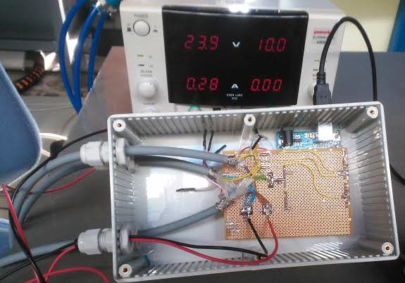

Communication and data transfer was easy to handle with LabView and by using myRio we were able to send pure analog voltage to pneumatic valves. At next stage the myRio will be setup to communicate via WiFi in order to reduce cables between computer and platform hardware. First prototype worked with Arduino and by this way the microcontroller was actually only voltage output card and performed poorly in that by "simulating" analog output with PWM.

Arduino Setup for valve control. 3 pcs PWM outputs are simulating 0-5V analog out, which is amplified to 0-10 V.
