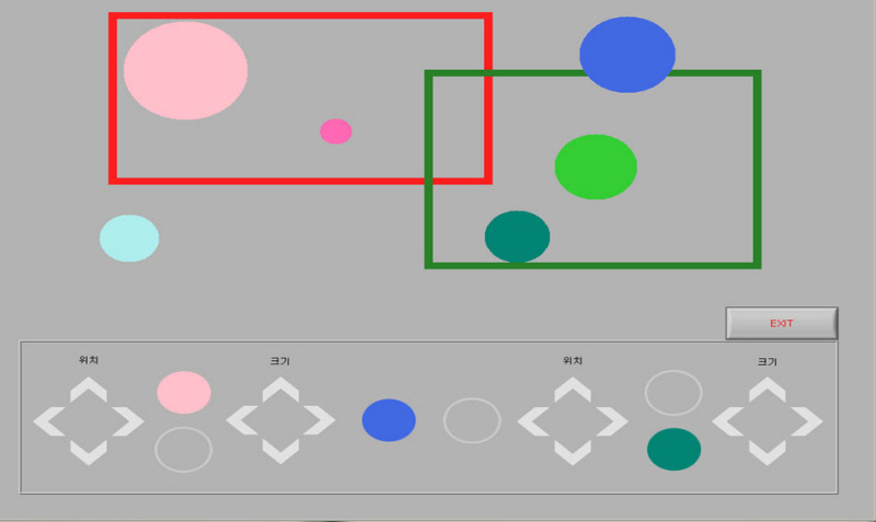

2. Window configuration and Operational principle
The window configuration of the STI system is as shown in Figure 2.
This system was composed of six buttons to select balls, buttons to control the size and area of the panel, and three panels.
.jpg)
2.1. Software
This application is a sound-effect-play system that enables users to make their own music. It is possible to create imaginary balls just by touching the screen. The movement of imaginary balls can be caused by dragging a table-display-screen. The differences in sound effects can be created by the movements of the balls. Users can give the freedom of movements to the balls by determining the size of the balls and by controlling the size and location of the panels. Also, in our system, users can make different sounds just by handling the balls. We used the intuitive interface type, which was easy to use for the purpose of enhancing satisfaction of users.
