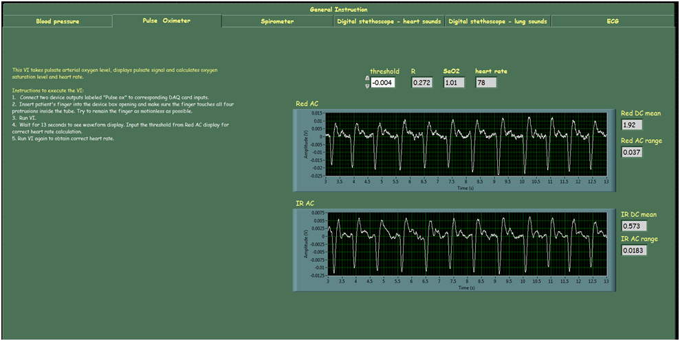

The goal of the project is to design electronic circuitry to accommodate the operation of five biomedical instrumentation devices, a way to interface all signals with LabView, and a program to display data from each device in one user-friendly program.
NI hardware: NI DAQ Card BNC-2110
NI software: LabVIEW 9.0.1
The proposed architecture of this project accommodates five different patient monitoring systems: a 12 lead ECG, a Pulse Oximeter and BloodPressure Measurement, and a Spirometer and Digital Stethoscope. These circuits are built on a circuit board using suitable operational amplifiers, differential amplifiers, resistors, capacitors and other required hardware. These individual systems are then integrated together into a single, compact and more practical design. Finally, the hardware is interfaced with a computer using LabVIEW software that displays data and generates results in a user friendly format.

Pulse oximeter in operation
Pulse oximeter LabVIEW front panel
