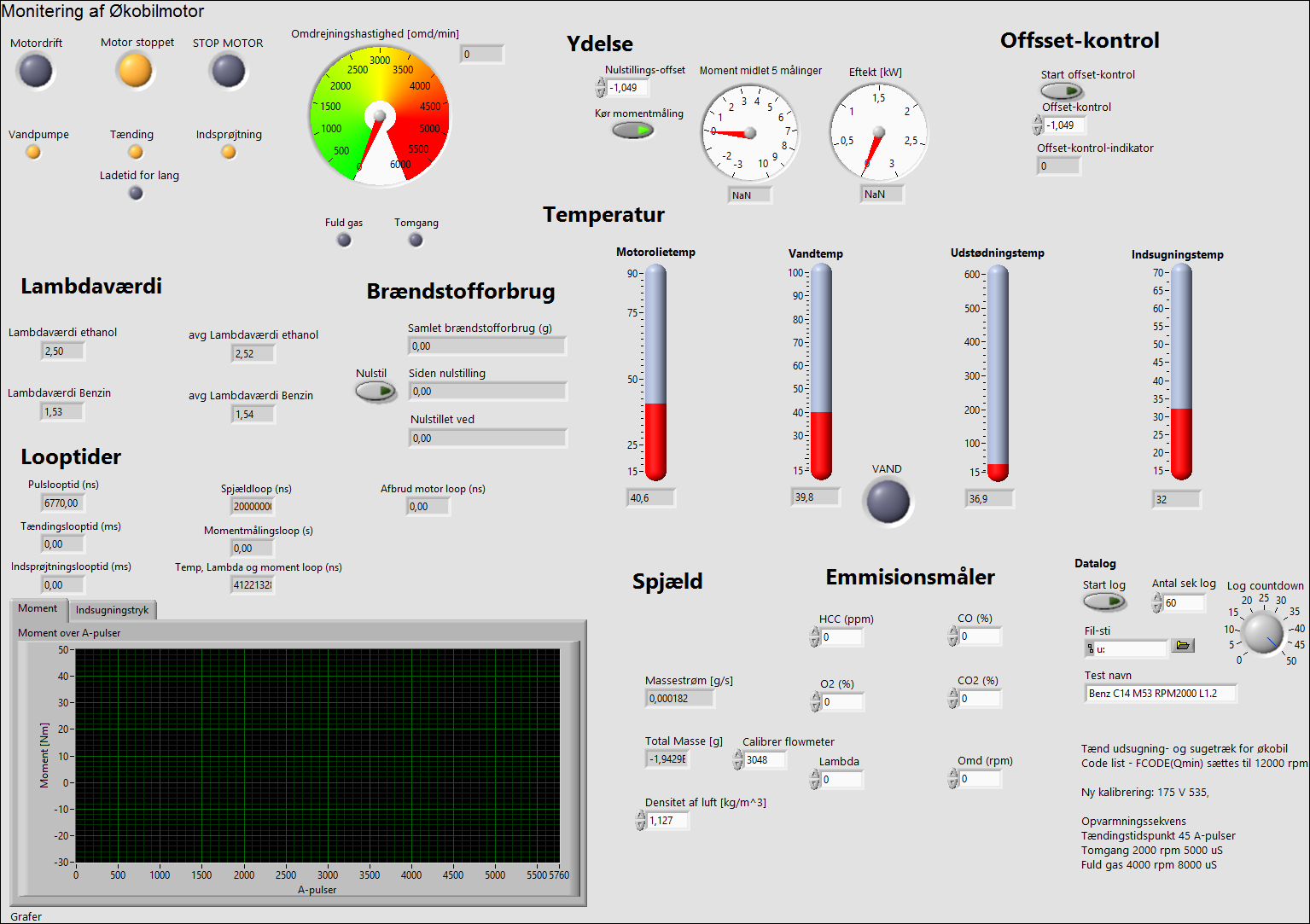

The signals, FPGA-target and PC are all connected through the real-time module of the CompactRio. The front panel of the VI running at the real-time module is shown at Figure 2. Here a varius number of parameters that sums up the status of the engine are shown. The most important of this VI is the capablity of saving/logging the measured data. This makes it posible to analyse the run of the engine and later calculate both the efficiency and the torque of the engine.
Figure 2: The front panel of the real-time VI showing the mesurements of the engine cycle

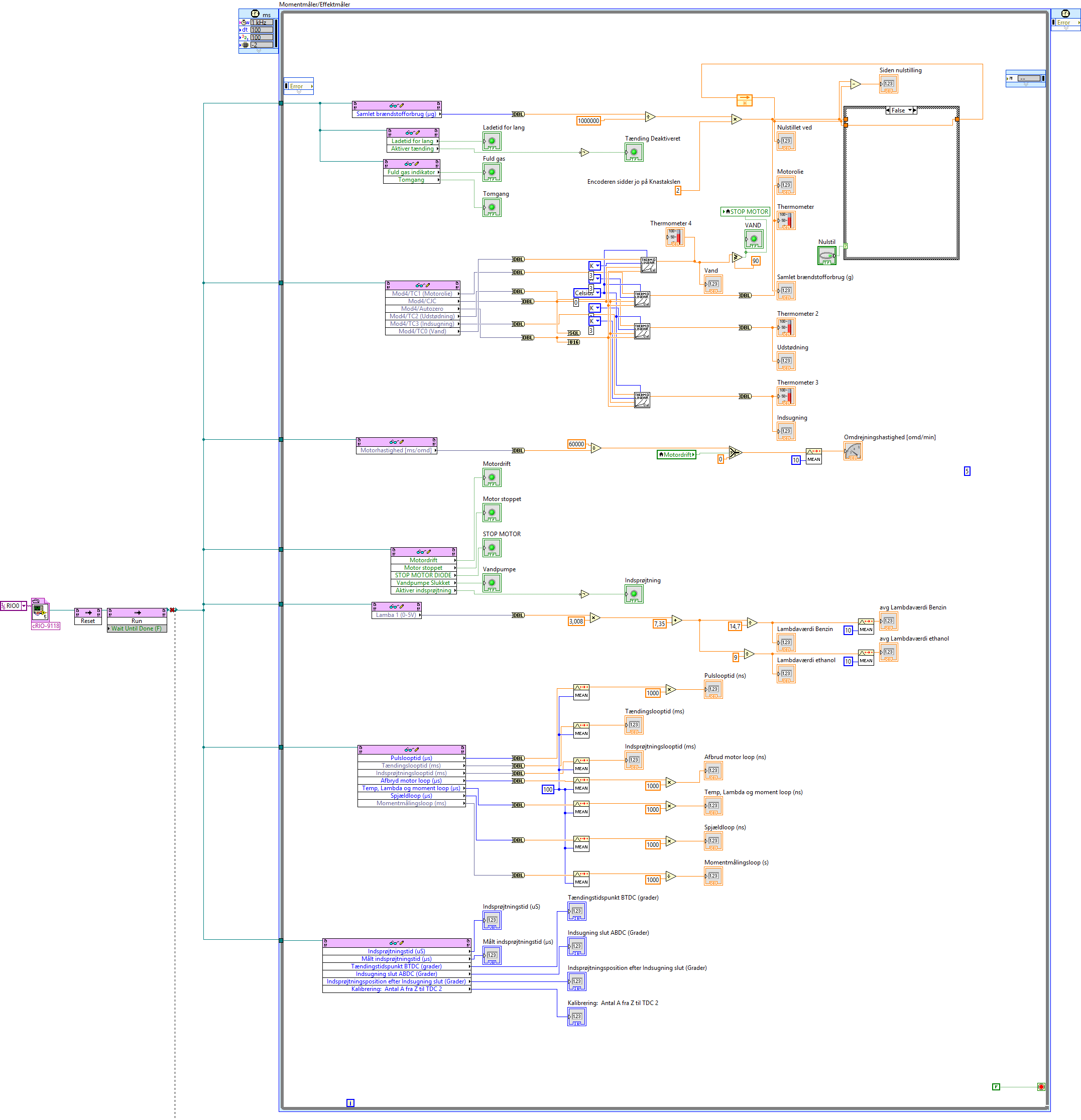

For analysing the measurements of the parameters of the engine the data on the FPGA-target has to be read onto the real-time module. On the real-time module most of the convertions of the signals and calculations of the parameters are done. This ensures the highest sampling rate from the FPGA-target. On Figure 3 the loop where the calculations of the temperatures, air-fuel-ratio, revolutions and indicators stating the status of the engine are shown. On the left side of the figure it is shown how the data from the FPGA-target are read onto the real-time module.
Figure 3: Loop for calculating the parameters showing the status of the engine
On Figure 4 another loop in the real-time VI is shown. Here the graph of the torque (Bottom left on Figure 2), the mean torque and mean effect of the engine is calculated. Through a FIFO method the measurements from a torque sensor are sent to the real-time module which are used for the calculations.
Figure 4: Loop for calculating the torque and effect of the engine

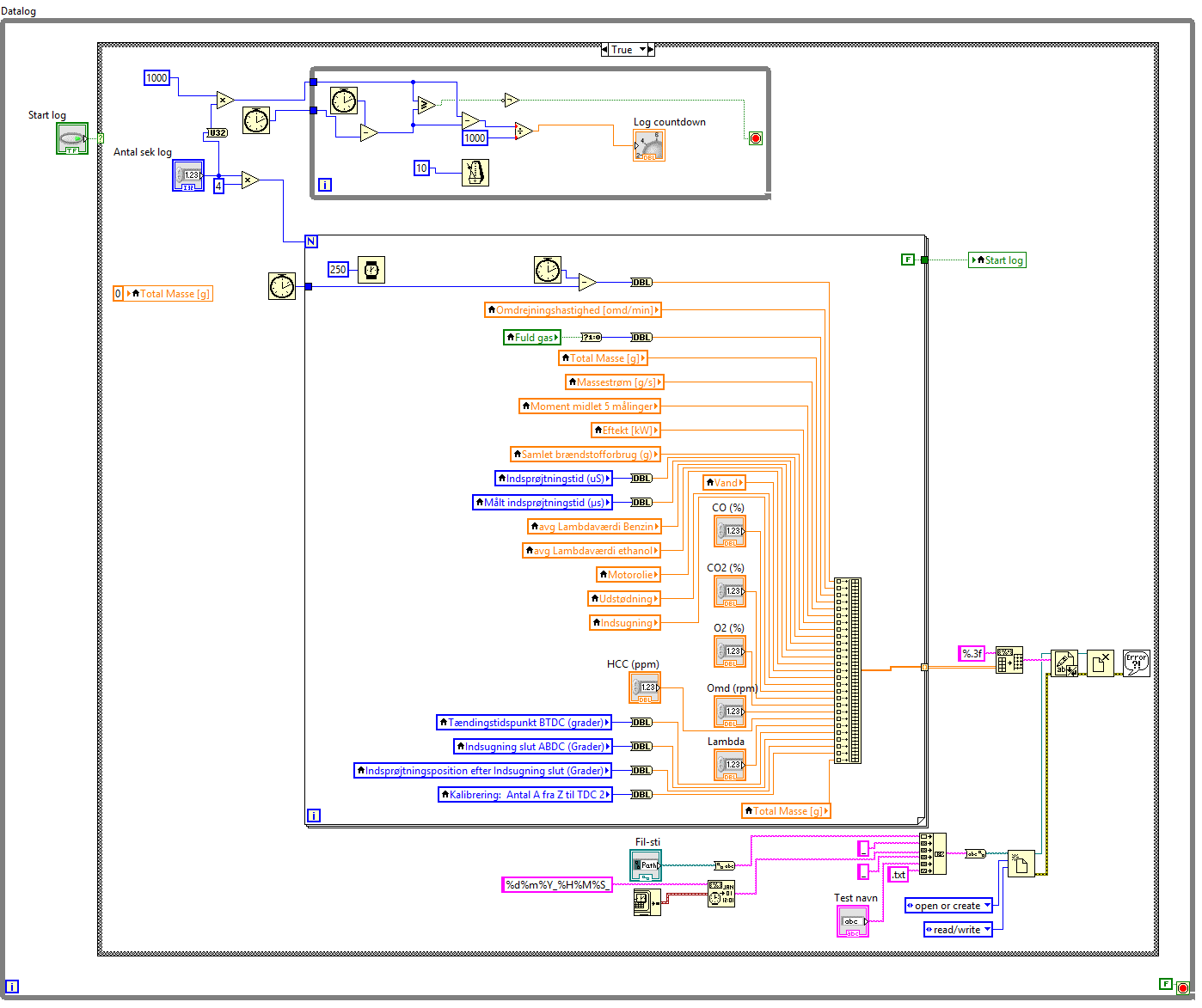

For the logging of the data the parameters are written into a .txt file shown in Figure 5 which can be read in for instance matlab where the test run can be analysed. On the front panel it is possible to determine the time of the test run, where to save the file and the name of it.
Figure 5: Loop for data logging of a test run
