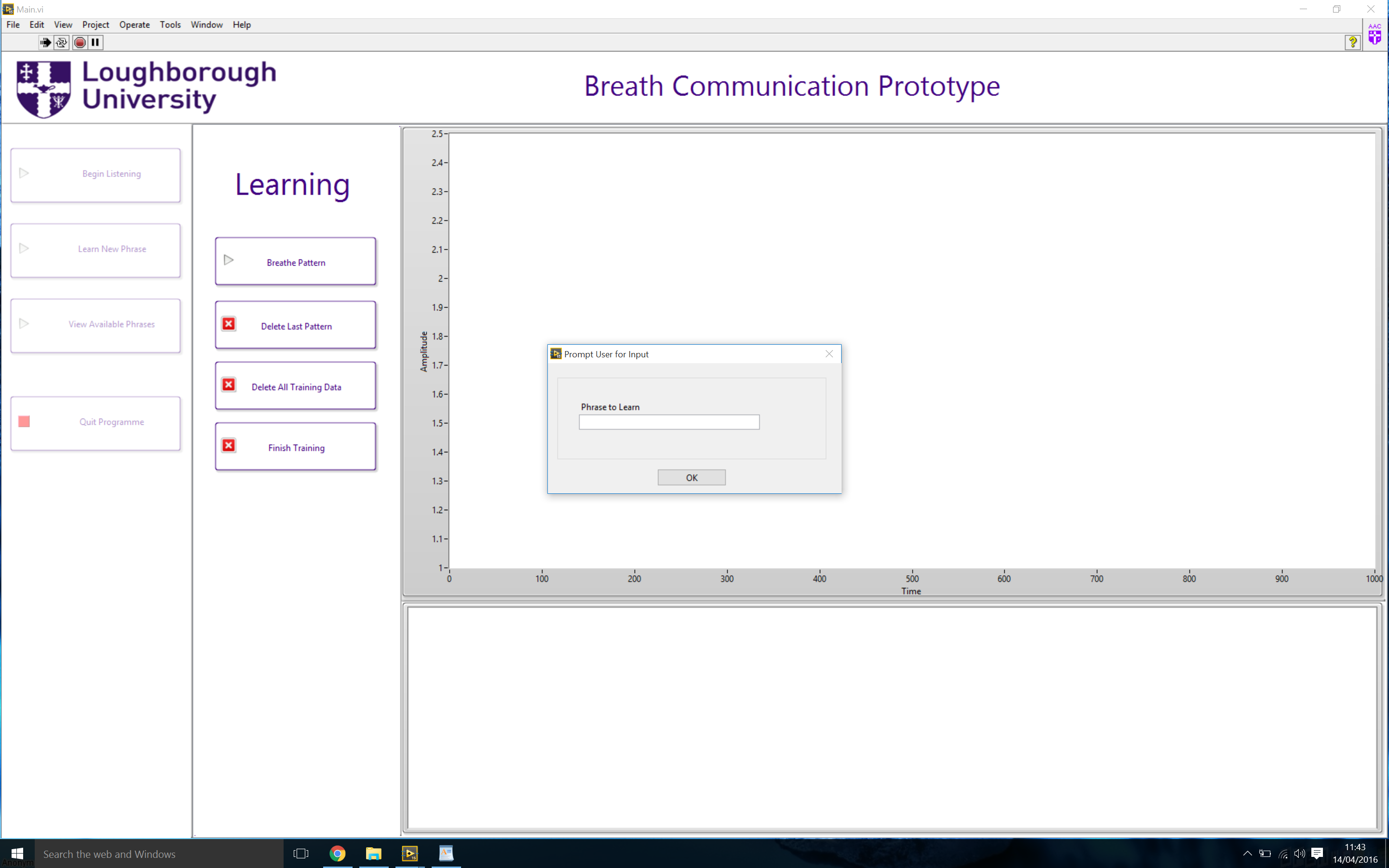

Before the Breath to Words system is used, a two-way learning process takes place between the machine and the user. By repeating the desired pattern for a word or phrase, the machine increases it’s understanding of the user’s breath whilst, simultaneously, the user learns to modulate their breath more preciseley. As both do so, the overall accuracy of the process improves.
To further improve usibility, we are working to increase the amount of feedback the machine provides to the user, so that the user can better understand how to improve their abilitythemselves.
Figure 3: The welcome screen interface
.png)
Figure 4: Teaching the system a new phrase
.png)
Figure 5: The system interpretting a breath and producing speech
