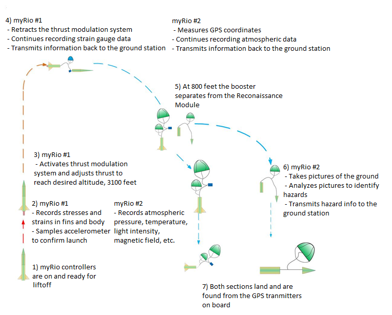

Figure 2 shows the launch vehicle flight plan with key tasks that are conducted by each of the myRios.
Figure 2: Flight Plan with myRio Tasks

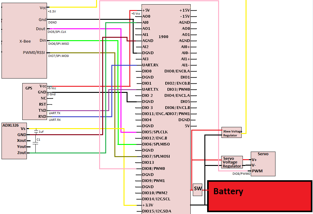

Each module contained its own unique set of sensors, the individual schematics for each can be seen below in Figures 10 and 11. The reconnaissance module contained a wide variety of atmospheric sensors and an IMU, while the thrust modulation contained an accelerometer and three-axis strain gauge rosettes. Each type of sensor was connected to its respective pin by use of ribbon cables that were connected to the MXP connector. The myRIO pallet, including its express analog and digital lines for the sensors, and both sets of TX and RX pins that were contained on the myRIO, were all used for the GPS and Xbee transceiver.
Figure 10: Reconnaissance Module Electronics
Figure 11: Thrust Module Electronics

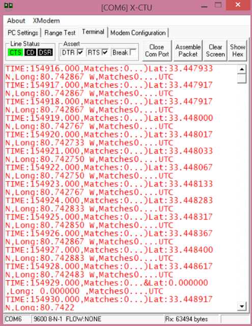

The first six recorded values of some selected sensors can be shown below in Table 1 as well as the receiving window of the Xbee transmission, X-CTU (Figure 12). Each set of data was recorded using the express function, write to measurement file. This allowed all the data to be saved in excel format to the myRIO. Applying a variety of numeric functions allowed for the resulting output to be represented in its corresponding unit.
Table 1: First 6 Recorded Results
| Pressure (Pa) | Humidity (%) | Photocell (ohms) | Strain (k Value) | Strain (k Value) |
| 60516 | 24.203 | 82879.83 | -0.3 | -0.1 |
| 60517 | 24.124 | 82044.95 | -0.3 | -0.1 |
| 60508 | 23.73 | 82460.51 | -0.3 | -0.1 |
| 60514 | 24.4 | 82460.51 | -0.3 | -0.1 |
| 6012 | 24.124 | 83944.96 | -0.3 | -0.1 |
| 60522 | 24.124 | 82669.69 | -0.3 | -0.1 |
| 60517 | 23.77 | 81633.12 | -0.3 | -0.1 |
Figure 12: Receiving Window of the Xbee

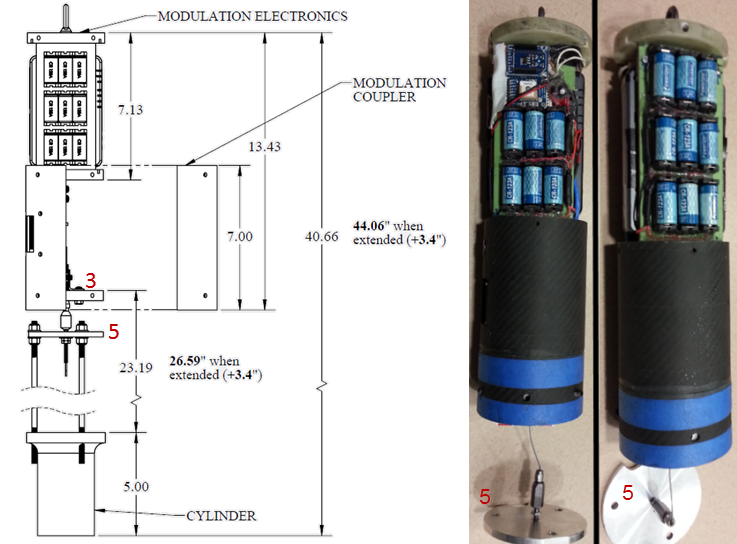

The second payload subsystem was the thrust modulation system, and its corresponding electronic control system. The goal of this system was to modify the thrust curve to a desired shape, proving the experimental concept and ultimately using this modification to dictate acceleration, velocity, and apogee altitude. The control system also used a second myRIO independent of the reconnaissance module and was housed in the booster section of the vehicle. The sliding mechanism to modulate solid rocket thrust was activated by a high-torque servo (HS-7950TH), controlled through a closed-loop PID system. The strain gage circuitry was also housed and interpreted in this payload section.
The thrust modulation mechanism is situated below the thrust modulation electronics bay, as shown in Figure 13.
Figure 13: Thrust Modulation Electronics and Controls Bay
Thrust Mod Operation and myRio Controller
Thrust modulation was achieved by extending an aluminum cylinder fitted with a ceramic insert into the exhaust plume of the solid fuel rocket motor. The cylinder was activated by a high torque servo motor and controlled via a closed-loop LabVIEW program with the myRIO using feedback from the onboard accelerometer. The desired acceleration profile was preloaded onto the myRIO as a csv file; and was automatically read by the program at each time step of the control loop, and compared to the measured acceleration value at that iteration. The difference between the measured and desired acceleration was multiplied by an empirical correlation constant, found through testing motors on a test stand built by the team, to find the required change in the PWM signal. The output value was added to the pulse width input of the PWM block in the LabVIEW program to adjust the servo angle and the extension of the cylinder incrementally at each iteration. The accelerometer readings were then used as the feedback from the effect of the extension/retraction to continue the process.

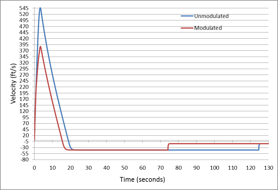

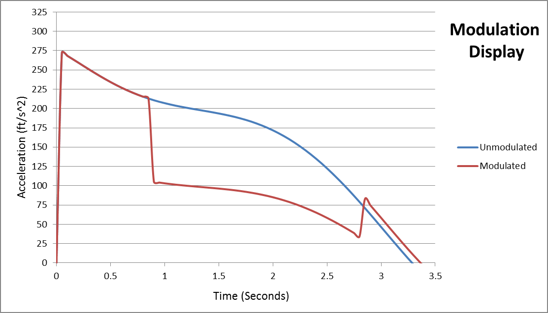

Extending the cylinder gave the exhaust gasses a larger expansion chamber causing an under expansion of the exhaust, a decreased thrust, and decreased acceleration. The control loop was constantly attempting to match the pre-loaded acceleration profile by adjusting the size of the expansion chamber created by the cylinder and limiting the final altitude to the desired 3100 feet. The acceleration profile loaded onto the myRIO was calculated using an Excel flight planner created by the team. The predicted altitude, velocity, and acceleration profiles were calculated with a flight planner made by the team using Excel. Figures 14, 15, and 16, below show the modulated (red) and unmodulated (blue) flight predictions.
Figure 14: Velocity versus time during flight
Figure 15: Position versus time during flight
Figure 16: Acceleration during motor burn
