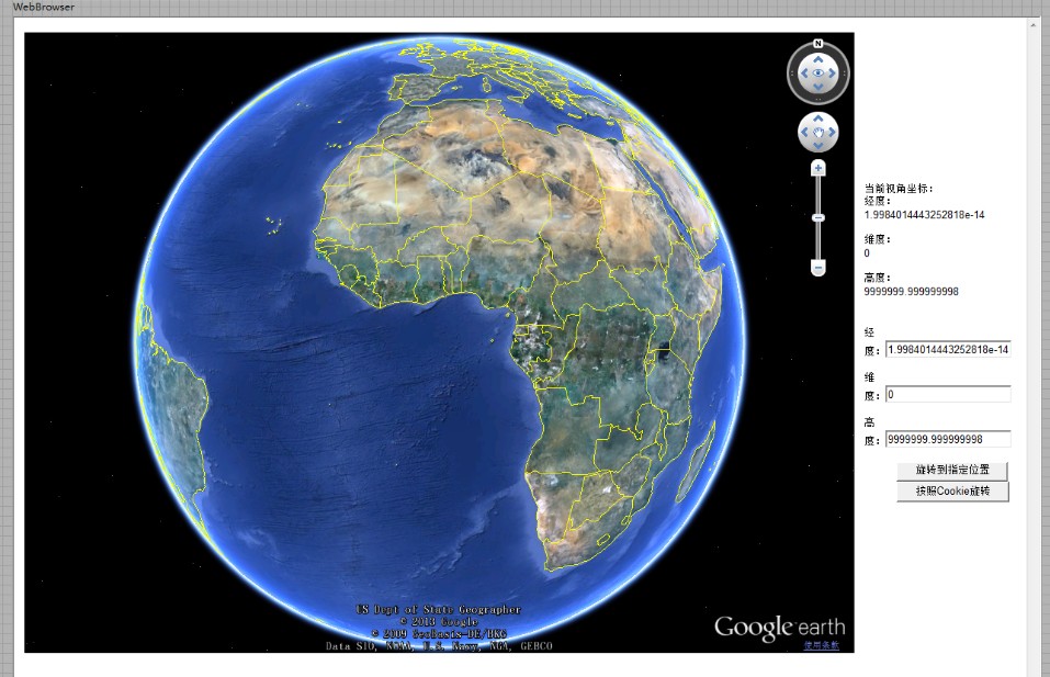

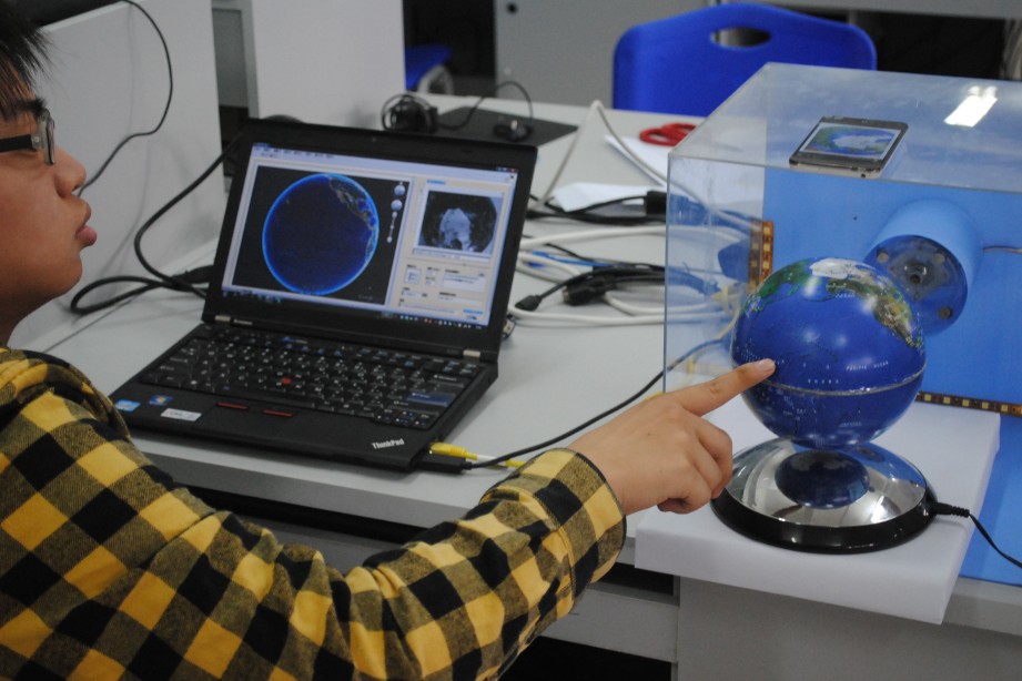

In our presentation system, you can see a Google Earth in the LabVIEW front panel, and you can control it with easy gestures. Meanwhile, a Magnetic Levitation earth can rotate synchronously with the Google Earth. In another function mode, the maglev earth can control the action of Google Earth, and the Google Earth can rotate synchronously with the maglev earth.

The control algrithm runs in the cpu of sbRIO, and the FPGA serves as a I/0 to control the stepper motor, and control the rotation of maglev earth.
We develope a Android app, to use the camera to take real-time photos of maglev and transfer the image to pc by wifi. The LabVIEW process the image, and get the rotation status of maglev earth, so we can synchronize the Google Earth's status with maglav earth's status.

1. Gestures control of Google Earth: open arms, altitude increase, earth get smaller, close arms, altitude decrease, earth get bigger; wave arms, the earth will rotate or stop.
2. The maglev earth rotate synchonously with Google Earth.
3. Reverse control funcion mode: a smartphone transfer real-time images to pc, and LabVIEW process the images and synchonize the Google Earth with maglev earth.
