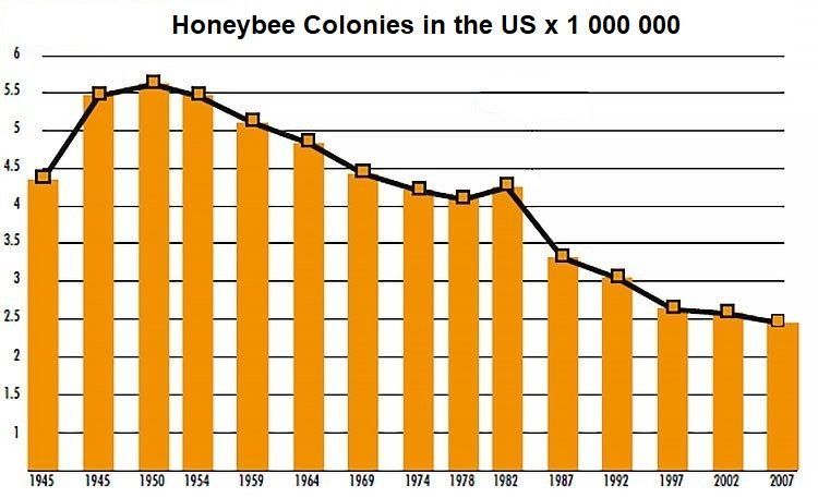

Honey bees are the world’s most numerous and important pollinator. They pollinate 1/3 of all food consumed and contribute over £200 million to the UK economy each year.
However, in recent years their populations in North America and Europe have been steadily declining. This phenomenon is now known as Colony Collapse Disorder (CCD) and scientists still do not have a clear understanding of it. This project aims to create a commercially viable beehive weight measuring system to help scientists and beekeepers remotely monitor colony health and further understand CCD.
Figure 1: Bee colony decrease in the past 50 years

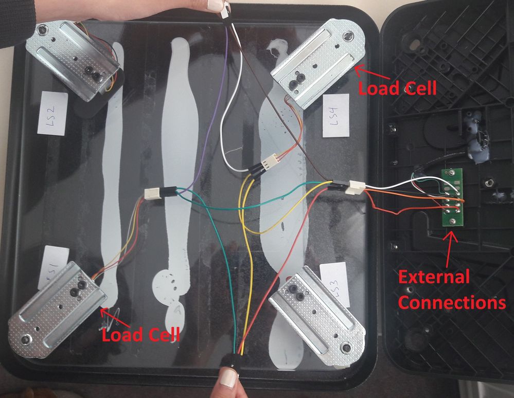

You're going to have to do some reading. I suggest you start with the NI white paper on strain gauges, as these tiny devices are the main method of weighing anything in our day and age. Now that you're all read up go and buy some load cells and fashion something that looks like a bathroom scale. Sounds a bit difficult doesn't it? I thought so as well. That' why I bought some high end off the shelf scales and retrofitted the load cells inside. I bought this lovely set and made quick work of the insides. It came with 4 load cells, but I only need 2 to form the half-bridge Wheatstone circuit - figure 3.

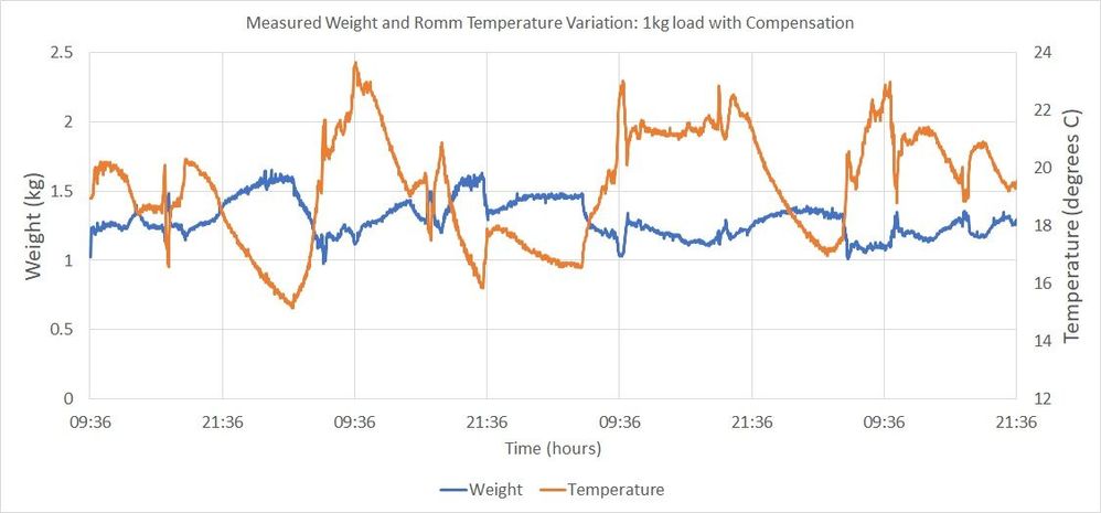

Now you need to add some form of temperature recording. I opted for a thermistor. Read through section 8 of the NI myRIO Embedded Systems Kit guide book. It covers all you need to know about thermistor temperature measurements. I highly recommend watching the NI Youtube series on thermistors. After you've set up the measurements you're going to want to map changes in temperature to changes in that conversion coefficient that I mentioned in the previous section. The easiest way to do this is by putting a load on the scales and having the system adjust the conversion coefficient, so that the weight stays the same. Then you need to analyse what conversion coefficient corresponds to what temperature. If things work out well you should see a significant improvement in performance - figure 6. The weight and temperature readings are decoupled. The mean reading is 1.05 kg and the standard deviation has dropped down to 0.15 kg - a sizeable improvement over figure 5. Next up - testing.
Figure 6: 1 kg load with temperature compensation

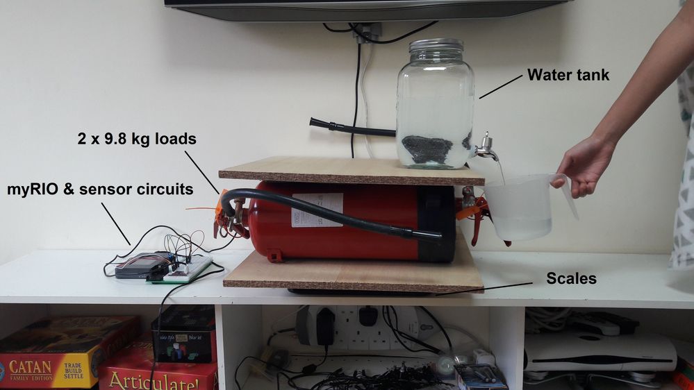

We can measure weight and compensate for temperature changes. Now it's time to see how well our system performs. In the beginning of the season when there is little honey in the hives from over winter, a British Standard hive weights around 25 kg and the bees inside weight only about 1 kg. Throughout the summer as the bees collect pollen and manufacture honey, the weight of the hive slowly increases to a peak value of about 50 kg. In the same time the bee population has also increased to about 10 kg. Through the year bees represent no more than 20% of the entire hive weight. Keeping that in mind I put together a simulated beehives using: 2 fire extinguishers, 2 plywood boards and a glass drinks jar - figure 7. The water in the jar represents the bees and by dripping it out I simulated how the bees leave the hive. I let the water drip out as slow as possible for hours on end and made sure that the system can detect the change. Then a measuring cup was used to cross reference the numbers from the system. That's the design and testing done. Now it's time to find a hive!Figure 7: Beehive simulation

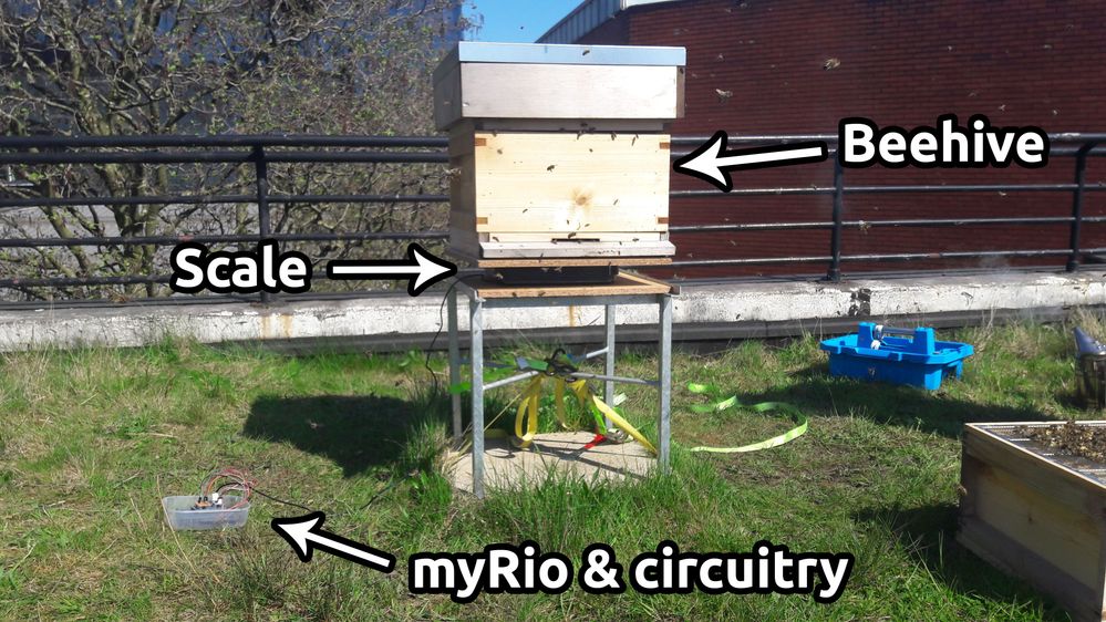

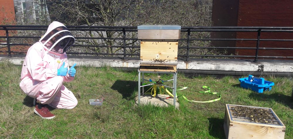

Manchester is the city of bees, just look at the city coat of arms, so hives are abundant. I collaborated with Dr. Simon Harper from the School of Computer Science at the University of Manchester. He was more then happy to let me test my system on one of his hives - figure 8. The bees are still shy, as it's been quite cold in the North this spring, but I am hopping to collect real hive data in the coming months.
Figure 8: Pretty in Pink

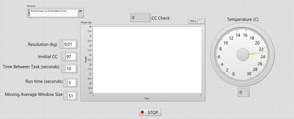

LabVIEW allows for rapid code prototyping, which greatly reduced my development time. The only community is full of helpful examples and guides, which helped me out when I stuck. The Wi-Fi capabilities of the myRIO and it's abundance of I/O ports allowed allowed for remote access and a plethora of peripheral devices. Below you'll find screenshots of the main vi that runs on the Real Time process on the myRIO. The software reads weight and temperature, performes active compensation and then records data onto non-volitile memory.
Figure 9: Main Front Panel
Figure 10: Main Block Diagram
