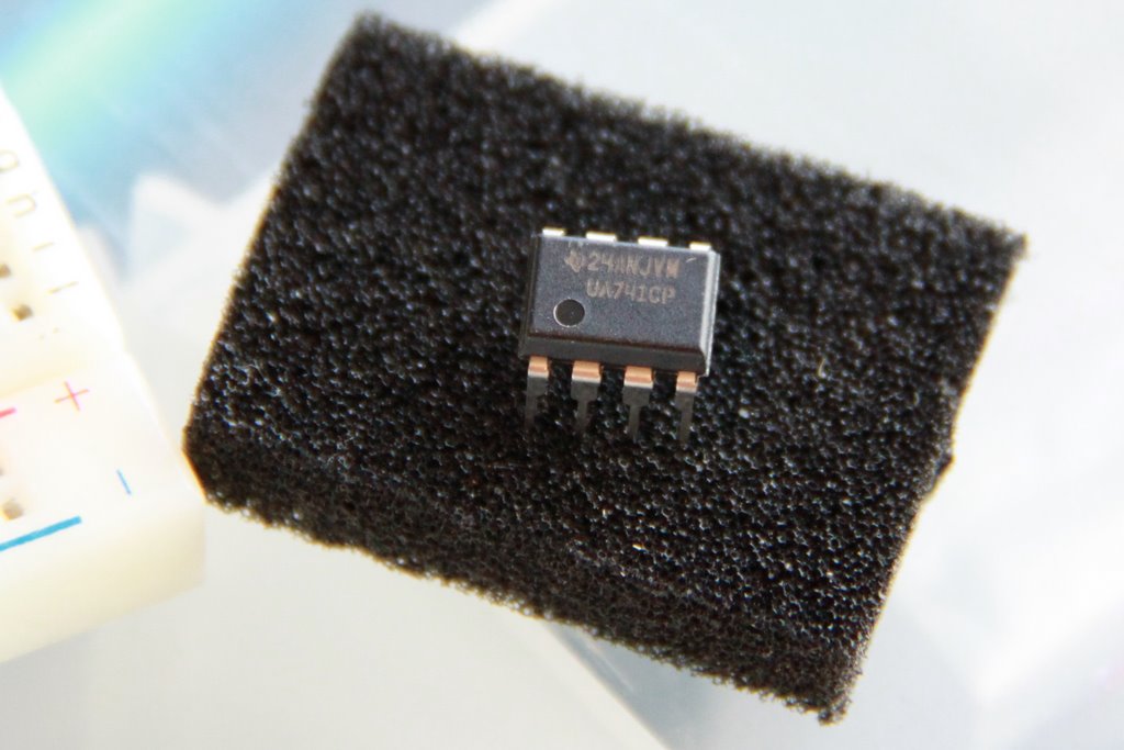

The first step is understanding the op amp chip you are using. See the following data sheet for the UA 741 Op Amp from Texas Instruments.
http://focus.ti.com/lit/ds/symlink/ua741.pdf

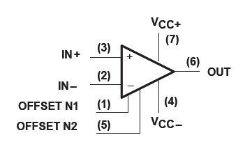

You will find two key figures, the first is the pinout of the chip. On the real device, the dot or the notch in the top of the on the plastic packaging can be used to find pin 1.
Secondly, you will find a diagram that shows how the pins correspond to the typical triangle diagram of an opamp.

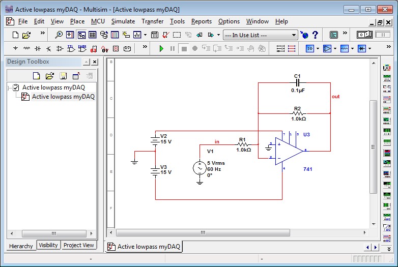

In this case I want to build a simple active lowpass filter. The only specification I designed to, was that the corner frequency should be around 1,000hz using parts I had on hand. My plan was to use the NI myDAQ Bode Analyzer to observe the filter behavior.
The capacitor I happend to have is a ceramic capacitor with 104 written on it. With some online research I found that the corresponding capacitance value is 0.1 micro Farad. Working backwards from the corner frequency of 1,000 Hz I need a 1,000 Ohm resistor which I had on hand as well.
First I designed my filter in NI Multisim 11 and simulated the results.

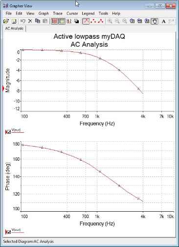

I clicked on the input wire and otuput wire to name the nodes and then set the AC Analysis simulation to sweep from 100Hz to 5,000Hz. I also set the Sweep Type to Decade and the Vertical Scale to Decibel. Secondly I went to the output tab and chose V(out) as the output to be graphed. Then I pressed Simulate.
The results looked good, consistent with my hand calculation. Now for wiring p the circuit! I validated that the pinout for the TI UA741 op amp pin out and the Multisim 741 component use the same pin numbers, so I simply built the circuit I developed in Multisim.
