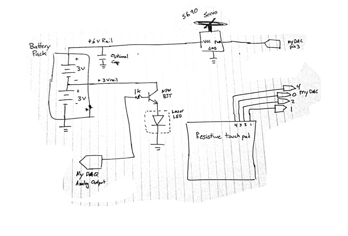

1. Wire the devices as shown in the diagram below.
2. In addition, wire together the myDAQ’s digital and and analog grounds, and ground the AI’s negative inputs.
3. Connect AI0+ to DIO4, and AI1+ to DIO4
Figure 1: Hardware schematic

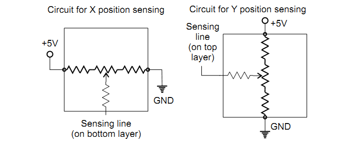

1. The Touchpad Routine: This routine rapidly switches the DIO pins connected to the touch pad between the two circuit diagrams below. When a DIO pin is not being used to provide +5V or GND, it is set as an input. The corresponding AI pins are used to read the voltage caused by the resistive divider created when a finger touches the panel.
Figure 2: Touchpad sensing schematic from http://www.sparkfun.com/datasheets/LCD/HOW%20DOES%20IT%20WORK.pdf
