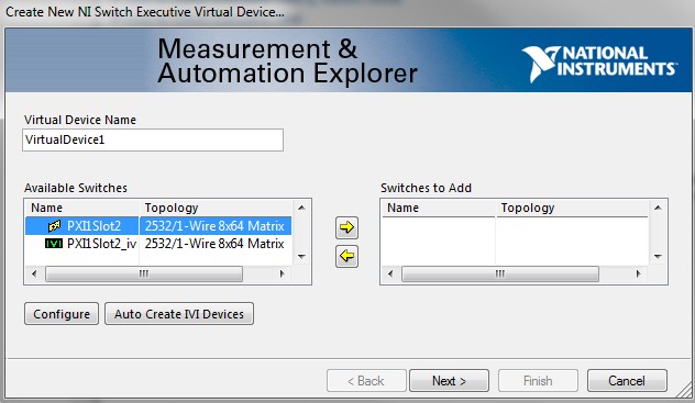

Create IVI sessions and logical names.  You could manually create the IVI sessions (as mentioned in the KB), but there's a MUCH easier method:
Right click on the NISE Virtual Devices tab and select 'Create New':
Click the 'auto create IVI devices' button.  A dialogue will pop up... just click yes:
The NISE Create Virtual device window should now look like this:
Notice that we now have IVI devices.  Sweet!  So now just click cancel (yes, cancel)... we only used this dummy virtual device to simplify the IVI creation process.
