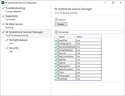

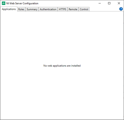

No applications are installed as per the screenshot, checking the systemlink server configuration (screenshot below) it seems there are some tag services running but not the messages service.

From the attached NIPM package list, it looks like you have the web UI and service packages for the tag service installed, but not the package for the message service.
You already have these packages which provide the tag service: ni-skyline-tag-webservice and ni-skyline-tag-webui
You'll want to install this package as well: ni-skyline-message-service
