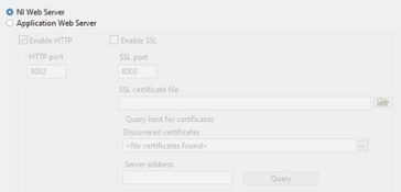

We saw that there is a new possibility in LabVIEW 2020 to configure Web services for the NI Web Server or the Application web server. Here is the screenshot of the Build Specifications for Application :
Once you choose that, great you have an exe (that I don't need) with my service.lvws file. I just discovered you can unzip it!
