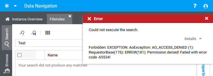

I have SystemLink 2020 R2 (20.1) and SystemLink TDM 20.1 installed.
I uploaded some TDMS files into SystemLink and started the default "FileIndex" DataFinder instance, which indexes the SystemLink File Service. I'm able to perform searches using the Data Navigator web app.
After a while though (about an hour?), I'm no longer able to search:
"Forbidden: EXCEPTION: AoException: AO_ACCESS_DENIED (1): RequestorBase(176): ERROR(181): Permission denied! Failed with error code -65534!"
Restarting the DataFinder instance seems to make the problem go away, but it comes back again after an hour or so.
So far, I've only used a single PC and single user account to use the Data Navigator.
What causes this, and how do I prevent it?

Hi Andreas,
The same error message appeared again today:
  • Different server machine
  • Same version of SystemLink + TDM
  • This time, it happened on a DataFinder instance that acts on a Network Share, not the SystemLink File Service.
I can confirm that closing the equivalent of the "FileIndex" Tab and reopening it in "Instance Overview" makes the error disappear.
