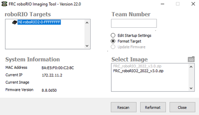

roboRIO 2.0 constant 3 flash orange status light in safe mode, we can not format the robot
We have done all diagnostics and met with another team to try and figure out why the RIO will not communicate. We continually get an error when imaging and the RIO flashes 3 times on status which indicates a hardware issue according to the manual. We need an RMA on the device ASAP so that we can begin programming and testing. This is our rookie year so every day counts.

So I got out our third Rio 2.0 and tried that.  On power up the status light blinks twice, I'm guessing it goes through a reboot (Windows sound for USB device change), then status is solid, then reboot again, and status light blinks three times.  Guessing it just restarted to safe mode.  The tool says that it finishes formatting, the is re-imaging, and fails after a minute or two.

The process has changed slightly between the original roboRIO and the roboRIO 2.0 - now we "format" the controller by imaging an SD card (https://docs.wpilib.org/en/stable/docs/software/roborio-info/roborio2-imaging.html), the imaging tool is only needed to set the team number once this is done.
Hope this helps!
